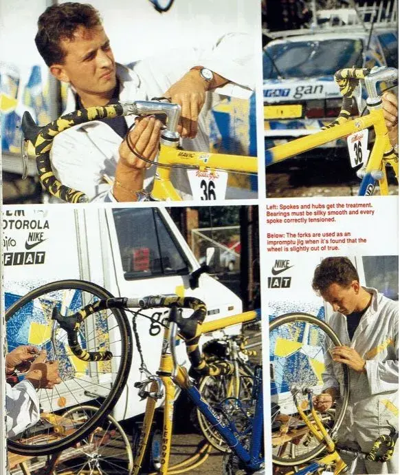

I am guessing the fork crown is similar. The columbus tubed bikes had the Greg Lemond signature stamped on the seatcluster and sloping Cinelli fork crowns
I'm currently restoring a Billato-constructed 1993 Lemond Team Gan frame made with Columbus tubing. Based on available scans of Lemond catalogs and close examination of period photos, etc., Lemond appears to have switched to Excel for the 1993 or 1994 season (which may have been introduced in the Fall/Winter of 1992 - although money issues plagued Lemond production/delivery). Early 1993 appears to have been Columbus' swan song with Lemond, building the flagship steel frames from TSX and the newly introduced Columbus Custom Lemond GL tubing, which I am told was simply rebadged Columbus SL. Development with Excel wouldn't have happened overnight, so it's likely frames made from both Columbus and Excel were produced at the same time.
As pointed out, the tell tale signs are the fork crowns, bottom bracket shell, and seat stays - which on the pictured bike all point to Excel tubes from 1993 or 1994 production. Which begs the question - why the Team Z paint scheme after 1992? Who knows?! But Billato churned out a lot of these frames so who's to say they didn't one off a frame with Team Z livery (notably without Z decals) at the request of a customer, shop, or distributor. Or built one up in late 1992 during development while Lemond was still under contract with Team Z? Or, as pointed out, it could have simply been a respray.
