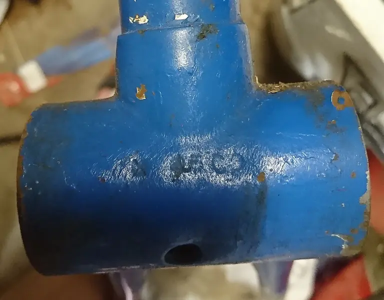

Thanks, I have tried to contact Bill Nickson in the past but my message went unanswered.
Regarding the wrapped seat stays and Carlton angle, I did a bit of searching yesterday and it does look a bit like their style but also read that they tended to stamp the serial number on the inside of the left rear droput. I can't see anything there. The only serial number I can find is on the bottom bracket shell. The number is a bit indestinct. I think it is X_?5_C/0? 0
I'll sand the paint back and see if I can make it out more clearly and have another try with Bill Nickson. Were super vitus dropouts used by other builders? Do the stay ends suggest anyone else?
