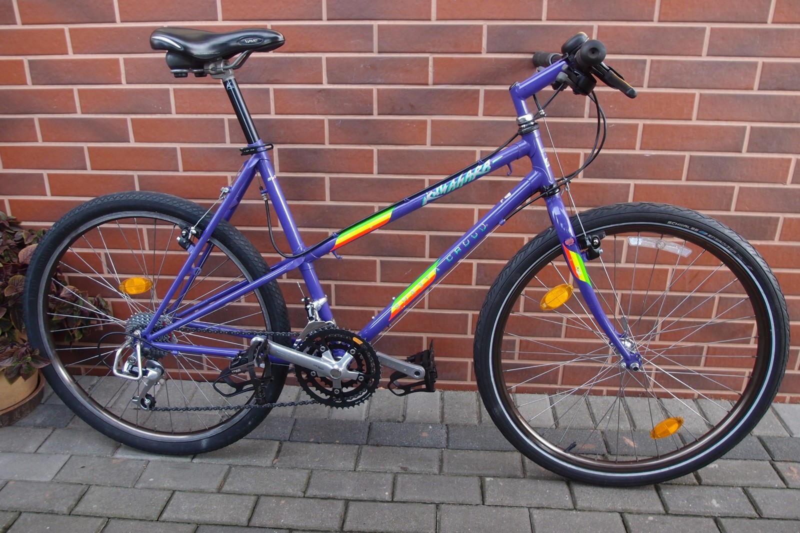

Ladies quality MTB preferably with XT groupset?

http://www.ebay.co.uk/itm/51cm-BIKE-KUW ... SwfZ1WYete
I came across a very small early 90s cannondale, it had the killer v style top tubing, so plenty stand over height. Pepperonis. Built it up with mainly m900 and its seriously light and fast. My partner is 5.5 and its perfect for her.
