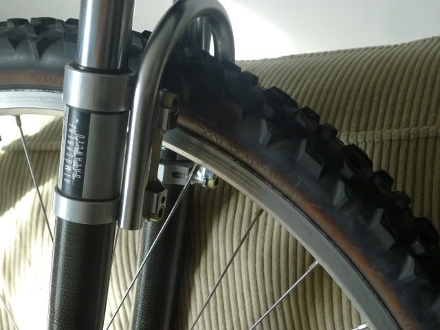

And a shot of the RC35's with the 4 bolt magura mounts...perfect for the frame.
