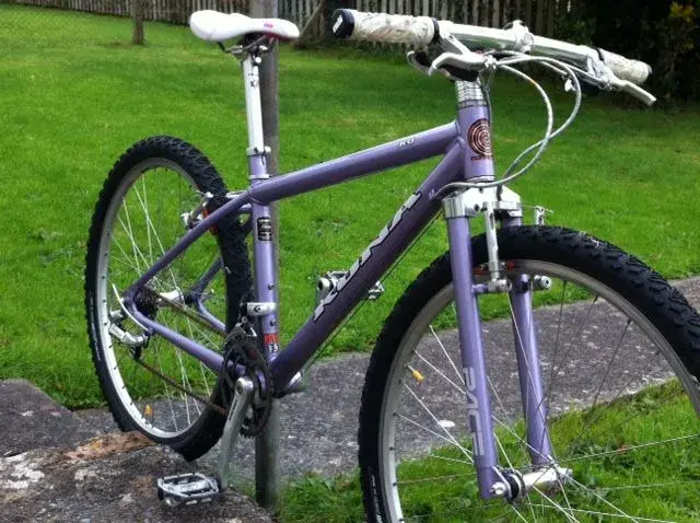

KU015 16” 1995 cable routing, 1995 decals - Lilac (formerly Blue), (Chapeau! Velo formerly LDP)

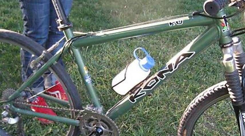

KU055 18” 1995 cable routing, 1995 decals - Metallic Green / Yellow Front & Stays, (Sandor via F.B)

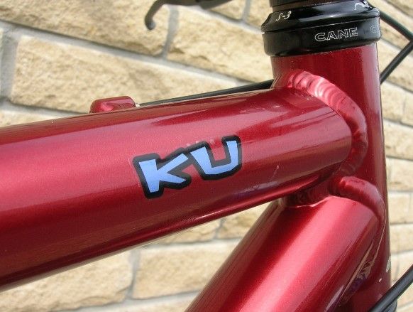

KU9702083 16" 1997 cable routing, 1998 original decals - Royal Mail Red - welded '97 February number 83, On display at Bellingham HQ (Paddy White), frame only.
KU041 18" 1995 cable routing, 1995 decals - Dark Green to Dark Grey, (Kona Guy, Facebook)
