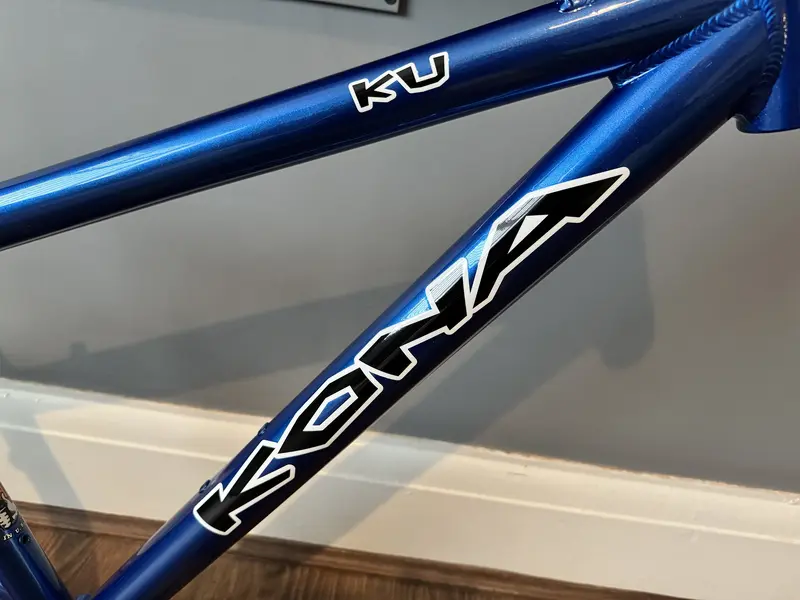

The issue with decals under lacquer is that you can feel them/ see them if they aren't waterslide. There isn't much alterative though unfortunately.

With ref to the decals, I agree the thickness is a negative but I’d prefer them to be under lacquer so I don’t see any alternative really.

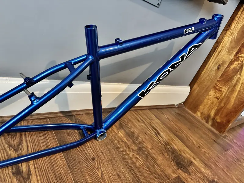

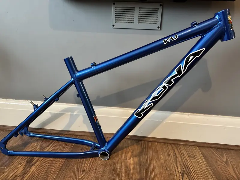

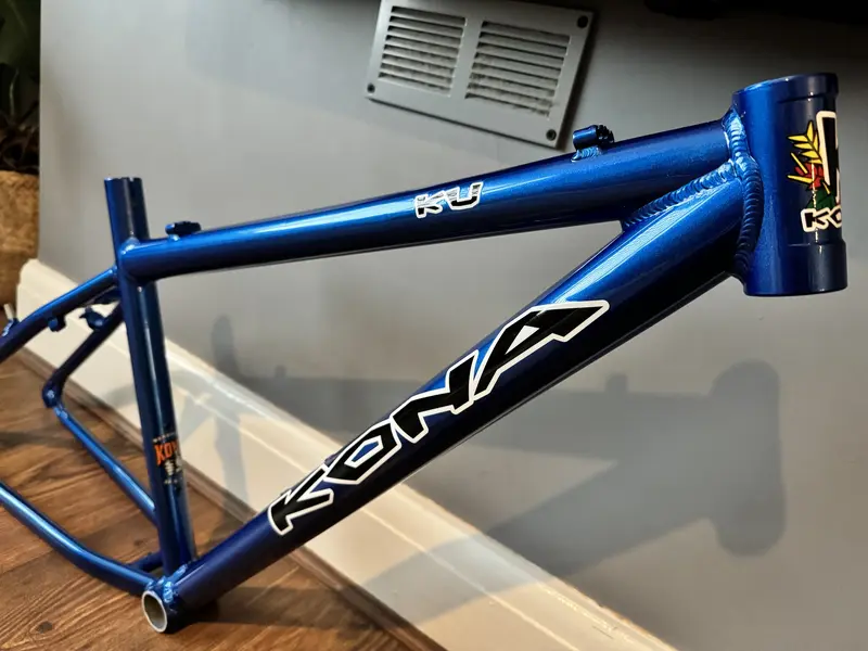

So my 98 Ku is back from Bluewhippet and I’m over the moon with it. I know a few people on here were against it being resprayed, but it was in really tatty condition and badly needed restoring to its former glory.
The colour is a perfect match, the quality of the finish is lovely and the vinyl decals under the lacquer don’t spoil it. Yes you can feel they are thicker when you run your finger over it but you can’t see it unless your up close and specifically looking for it.
To say I am pleased is an understatement!
