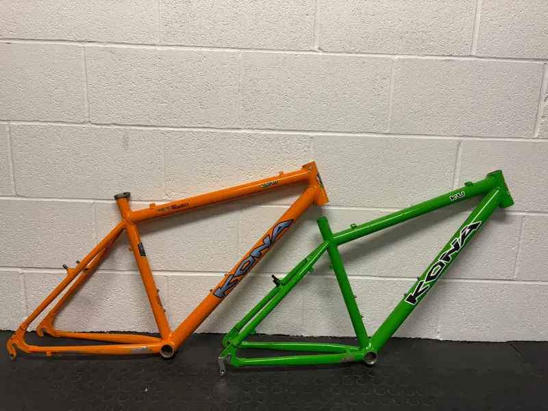

I can confirm that this is definitely the correct serial. The last 1 is visible under fluorescent lights quite easily
H9A00511 16" 1998 Bright Green - Hodaka, 1999, Control Code A, October, 0511 (Franceso), hard to make out second 1
