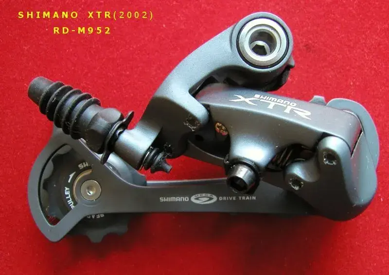

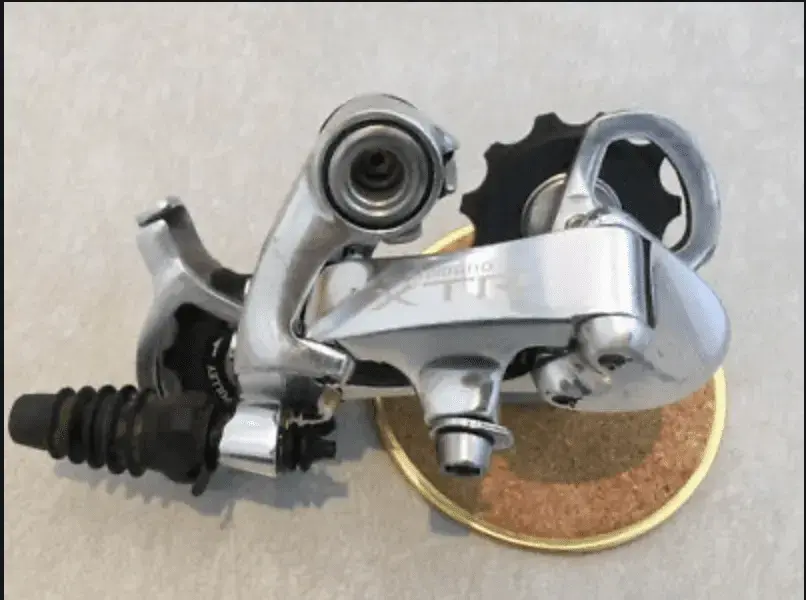

Remember our previous private conversion about your silver XTR rear mechs, and whether this was due to bleaching versus versus being a stock finish, and where I thought I'd matching silver shifters for sale new from before? Yours may not have been polished but I believe that they were part of a rare variant of the M-952 Mega 9 series line-up that Shimano produced named '30th Anniversary'.
See pics of a polished silver version from this special edition.

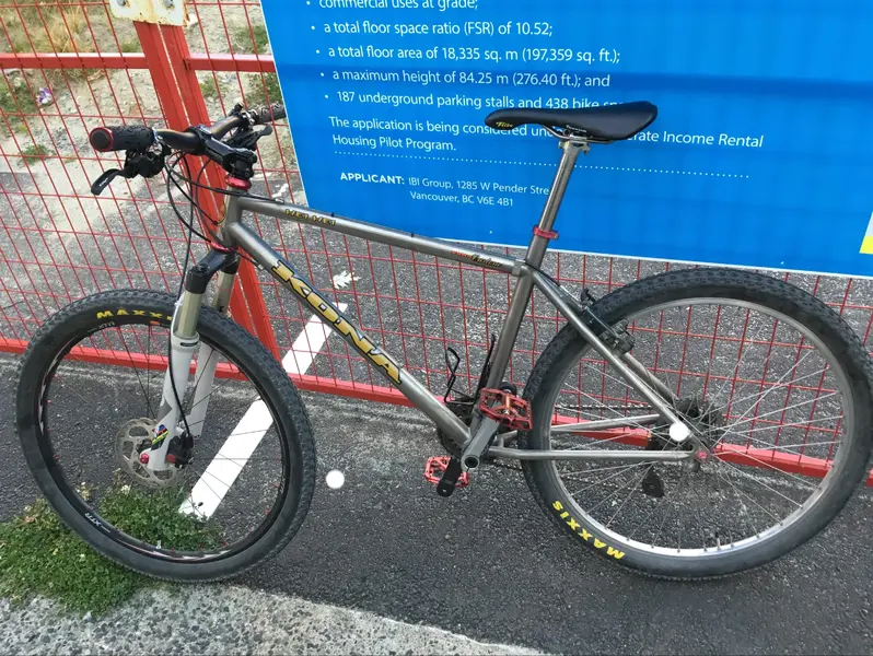

Re: driving force to make the change, it was a combination of the 3 factors below. Even though selling the HH hurt, given it was unique in it's own way, with original decals and the early top-tube routing, overall right now it just makes sense for my purpose of riding.
Firstly, I wasn't too chuffed with the XTR V-brakes. Even on ceramic rims, the braking power didn't seem to be as significant-a-step up as I imagined from cantis. But more so, I really disliked the XTR black grub screw centring-adjustment that, by nature of the design, would strip over use in changing tires over. I could have transferred to a set of Avid Arch Supremes, at cost, but as the build had been completed with full M950 XTR (being a fan) I was resigning myself to keeping it that way until this KK popped up..Why couldn't they just use worm-hole keys like M900 and M730s?
Secondly, there is a bit of inherent flex on HHs around the bottom-bracket area due to the nature of the spring in Ti. If you turn the wheel to angle, and push the cranks, the bottom-bracket area will flex with give. Whilst this is not a bad thing, for comfort/ compliance, it's also nice to have a bit of more of an efficient drive connection when getting power-down.

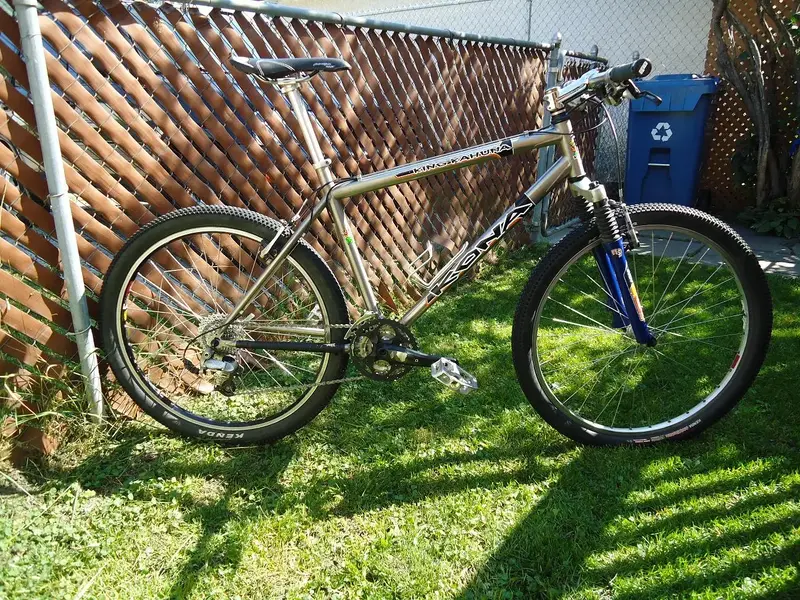

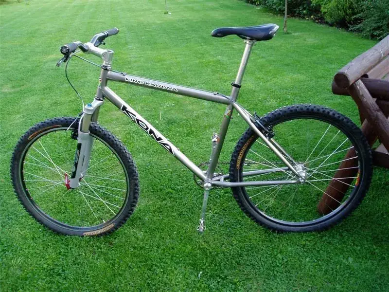

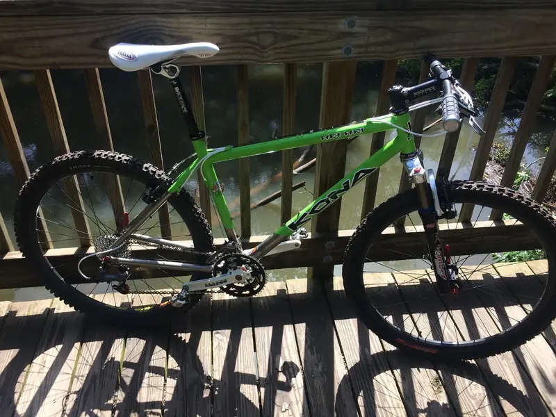

Thirdly, I'd been thinking of a more modern ride for a while now, when doing less XC, or single-track, and more burier descents (See pic of this North-Shore HH running a white SID) With also the retro decals on Kona's 2019 Process', raced this year, it got me thinking about advancements to retro-builds in general.
Although I'd seen a few 19" bare KKs, I'd not seen a 20" KK in over 3 years looking until last month. With factory mounts for disc-brakes, it just made sense in wanting a more up-to-date ride, especially with the economic advantage of retaining existing componentry that I'd built up along-the-way with the HH..
That said, it may also be a good opportunity for something with more travel than a Z2, in going for a Z1 or lighter Rockshox SID Race ..?

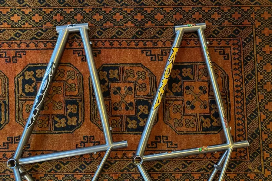

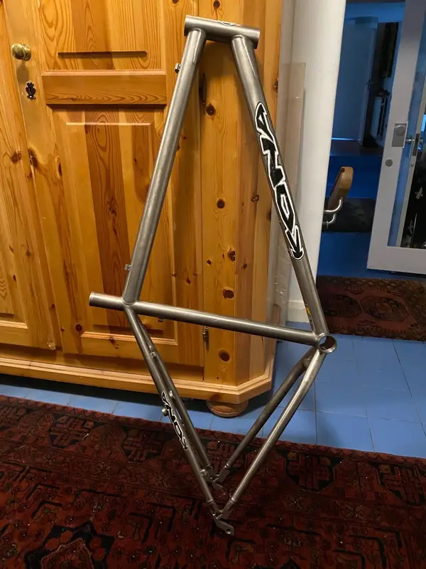

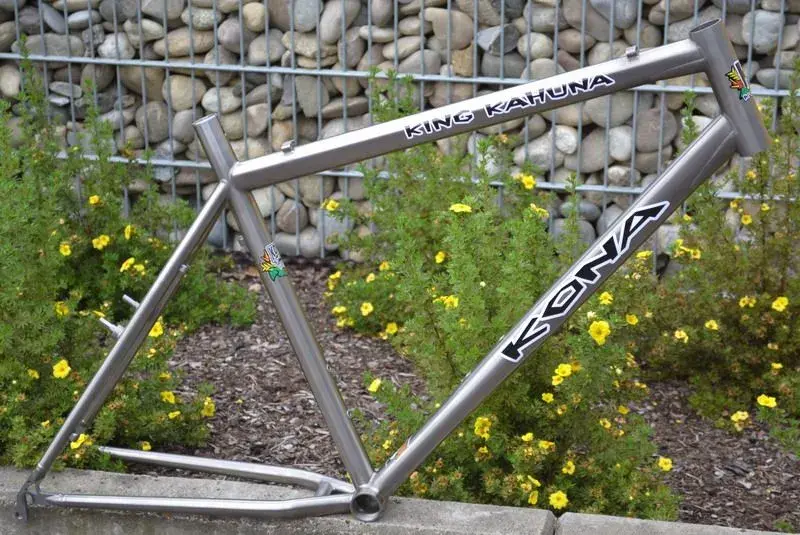

Frame arrive safe and sound from the US. Will upload some better photos soon but some first impressions out the box:
- 'Balloon' decals are in better condition than anticipated. Despite being a couple of years later than the frame, they appear all to be factory originals sporting silver font outlines.
Remains a mystery as to why they are there, but having spoken to the previous owners, there's an indication that the frame originally might have been supplied with these from new.
- Although well packaged upon arrival, the brake boss spring clip holes had some minor rounding-out of the holes. It shouldn't hinder V-brake use, if I go do that route.
- Frame is nice and true without dings and just the usual wear and tear by way of scratches that will polish out.
- BB threads intact. Nice and clean
- Factory disc tab looks the business and overall very excited to get this built up.
Some decision making processes to be had, namely the fork choice and whether to go straight or riser bar.
The largest decision is whether to retain Vs with M950 shifters, or go with a more modern 9-speed set-up using Formula Mix-Masters.

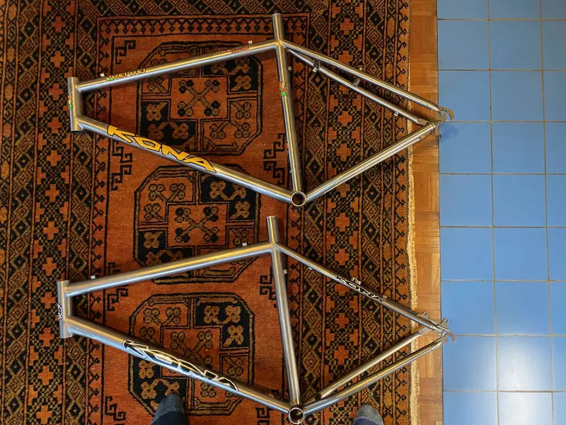

Before I sold the Hei Hei, I did some record comparisons on weight and length of tubing out of curiosity. I knew from previous postings that the KK would be marginally heavier (for one, just look at the difference in that extra heft where the head-tube abutts) but there were some other slight differences:
Weight:
HH: 1688g
KK: 1761g
From visual inspection, the downtube angle seemed to be fractionally steeper on the KK, but this might have been visual trickery of extra ovalised tubing combined with the gusset plates. I then measured the top tube and found it to be marginally shorter, that support my hunch that I was alittle surprised at:
headtube:150mm (same)
seatpost stays: 485 (same)
rear stays: 425 (same)
top tube: HH 585 KK 580
The KK does look and feel like quite a different beast. Please excuse the odd socks.

On my 1997 HHKK (also with a two-piece factory disc mount), I run a 2001 Fox F100 RLC, lowered to 80mm travel, which works very well, this has an a/c of 450mm. I tried 100mm (470mm) but with flat bars and a 100mm stem felt a bit chopper-like and the steering tended to flop. The previous owner ran 100mm travel with a short stem and risers, so maybe is is just me....
Check out my build thread to gauge the look / stance.
SP
Thanks SP - that’s a very nice fork. I was looking into the Fox 80RL as a possible candidate.
A Fox versus say a Marzocchi or a Pace fork however lends quite a different overall appearance to the build.
Minimising travel height is an important factor to getting it looking right.
The Z1s were raced on KKs for the burlier races, given weight on the heavier side. I also suspect that at 100mm, they had their travel height margainly reduced to avoid the upright front-end.

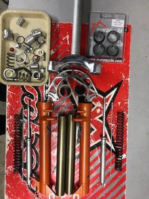

Some progress on forks:
Received this picture from MtbforksbyMark today of the Z1 BAM he’s tracked down for the build. I think it should be just the ticket to complement the frame.
Travel height will be adjusted to 90mm.
“Every part has been cleaned inside and out with a toothbrush or similar cleaning device, all small parts have been cleaned in an ultrasonic parts cleaner, crown has been polished, new uncut steer tube installed, both cartridges have been cycled and flush clean, stanchions have been polished”
- Legend -
New arch bolts, Heavy duty springs, new factory seals, factory oil and rider weight tweaks will be done later this week before shipping.
