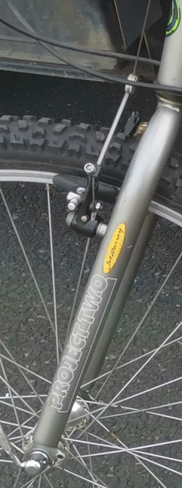

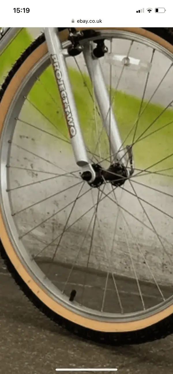

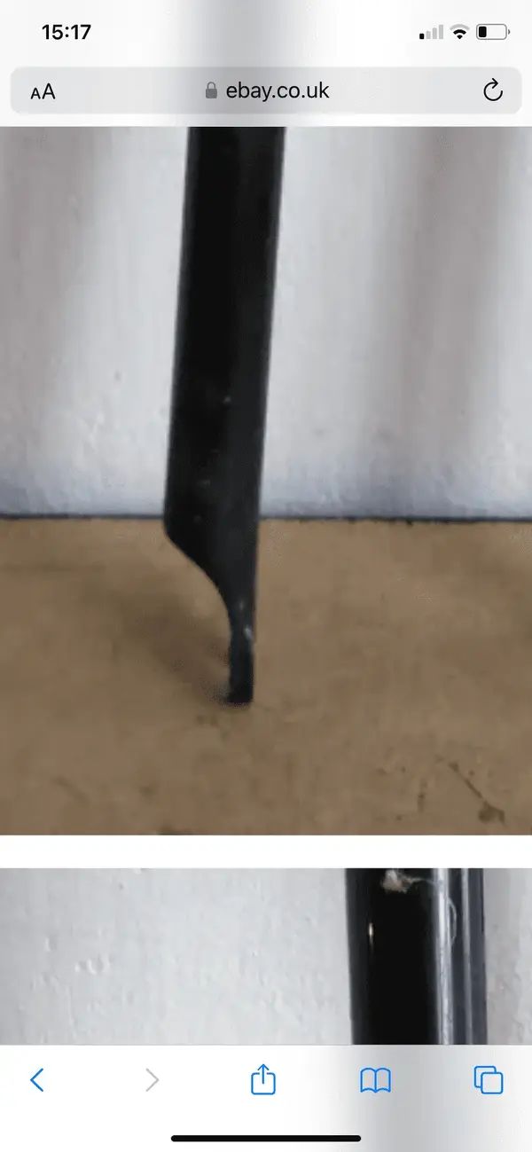

Non TB forks never came in 1 1/8” if I recall?As far as I can recall TB p2’s look sculpted at the drop out.
Rather than the main fork leg ending almost square and then the drop out being a thin extension.
This might not be true for all but that’s how I used to hunt them out.View attachment 782510

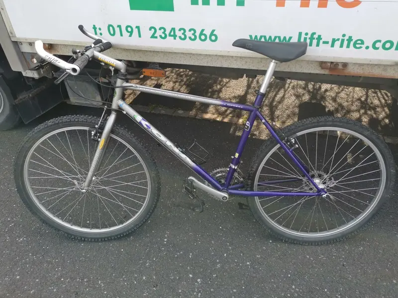

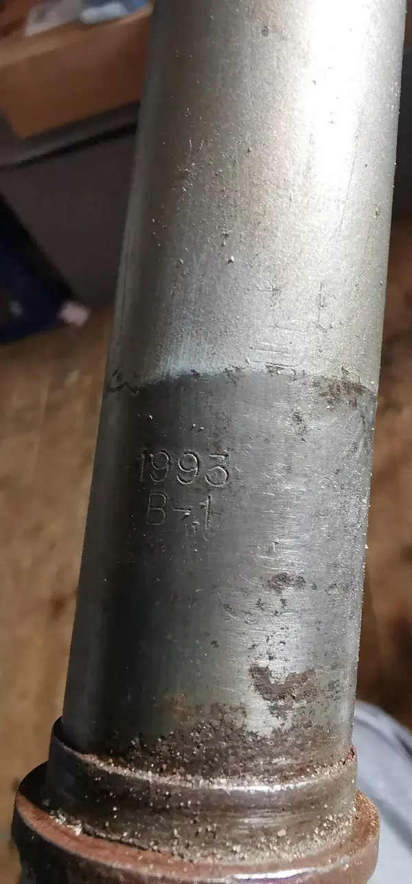

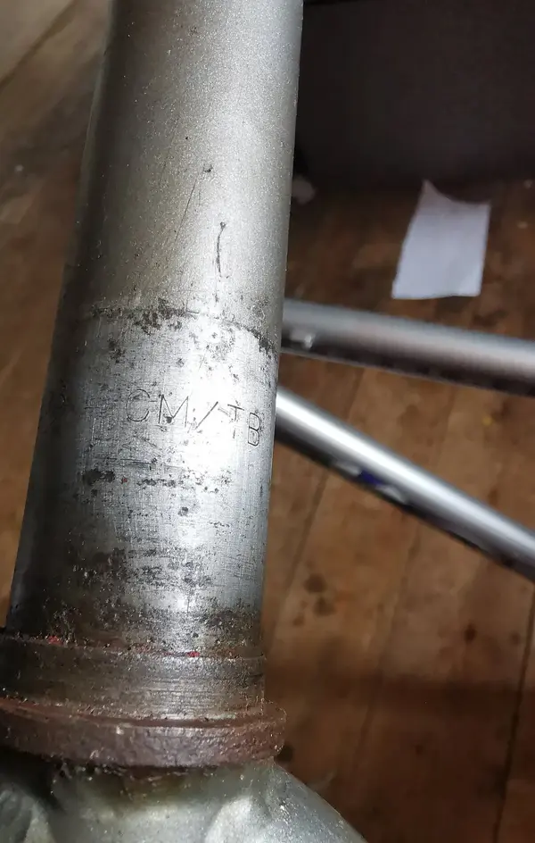

That said, Tange Prestige tubing had a bulge-butted seat tube, i.e. the seat tube should be noticeably bulged below the bottle cage bolts (photo showing '94 and '95 Kilauea frames side by side). Can't see that in the 3rd photo of the starting post showing just the frame.FWIW, got a '95 P2 TB (resprayed but TB engraved on the steerer tube) with similar boxy fork bottom ends. Also got a '94/'95 TB with the curved/tapered ends, so guess there's different varities around.
Doesn’t look like it’s bulged. More ovalisedThat said, Tange Prestige tubing had a bulge-butted seat tube, i.e. the seat tube should be noticeably bulged below the bottle cage bolts (photo showing '94 and '95 Kilauea frames side by side). Can't see that in the 3rd photo of the starting post showing just the frame.
