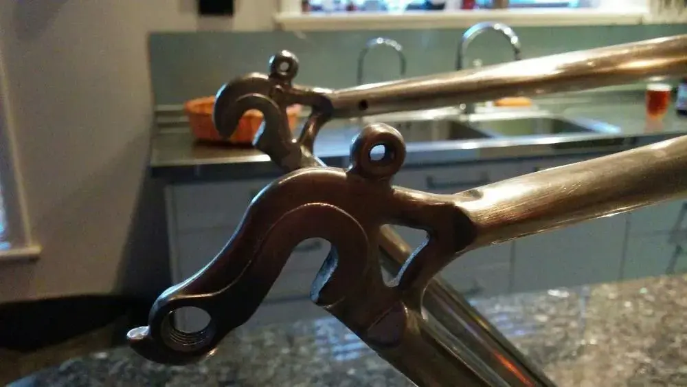

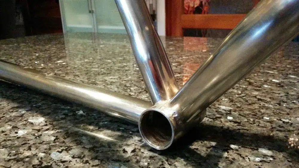

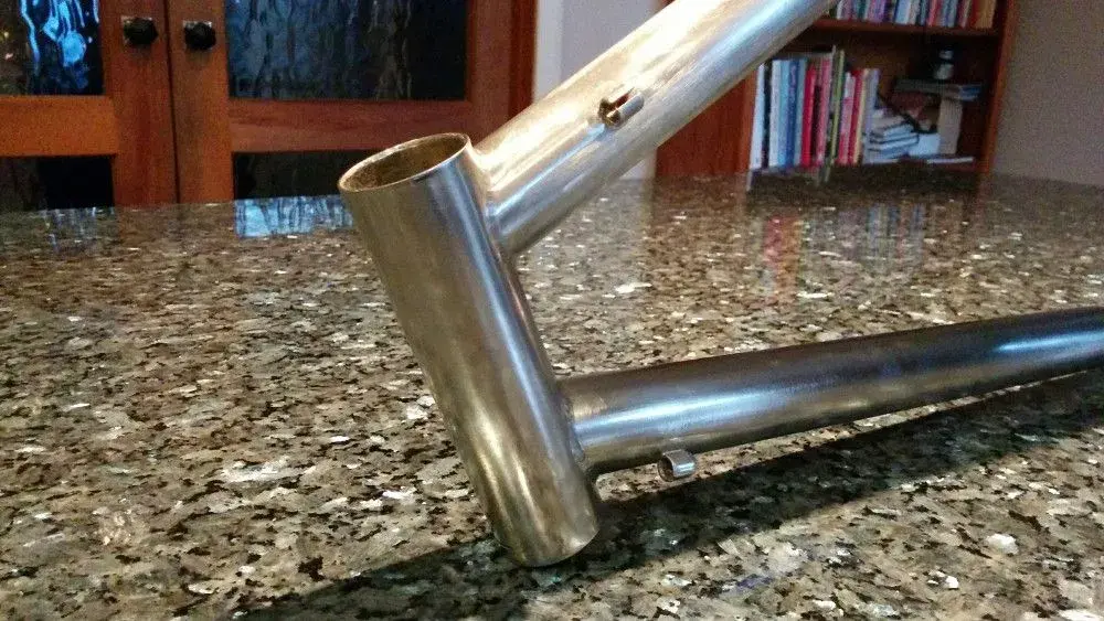

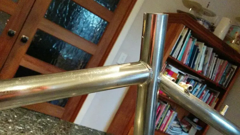

Wondering if anyone can help me identify the model and year of this Kona frame. Serial number is 'F1079136' other markings on bottom of BB shell are '2I 18' weight is 2050g in it's current ROAR steel state.

I think FluffyChicken is the winner!
I have a 20" 92 Explosif Pro with the exact same dropouts and a similar serial: F1079427
For the reference, my reasoning.
The date says 1991 build (second character) so it's a 1991 or 1992 model without thinking to hard.
The bulge butted seat tube was only in the Prestige Concept and the only frame with that is the Explosif or Hot frames of 1992. First year the BBT (bulge butted tube) appeared iirc.
