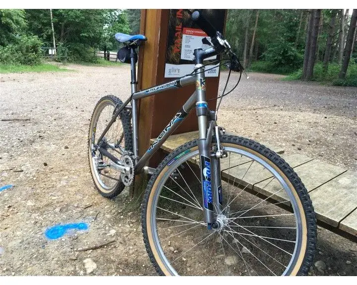

First proper ride today - two laps around Swinley as a shake-down run. The first felt awful, the second after some tweaking was spot-on.
Spec is as follows:
Frame: 1997 Kona Hei Hei King Kahuna with later factory disc mount and 1999 decals
Fork: Fox Float F100 RLC - travel dropped to 80mm
Headset: Chris King with Ti base plate
Stem: Ritchey WCS

I've been using this exclusively for MTB. My modern bikes are now relegated :D
I did swap the original tyres and fit modern Michelin ones for better grip. Currently it is muddy and the chain is all cacky with oil - but it shows I used it :wink: Unlike my '93 Explosif which hasn't been ridden since Mayhem 2017!
SP
Last February I 'broke' this :evil: . The frame had been repaired with a couple of BB threaded steel inserts (I didn't know that when I bought it) and when out for a retro meet, the shifting went all to pot.... I couldn't select the outer chainring. It turned out the drive-side insert had migrated outwards of the frame, taking the BB and chainset with it!
I have pressed and Loctite'd the sleeve back in and ordered one of those modern (*spits*) Hollowtec II XT chainsets. The idea being that the lateral movement is restricted either way by the opposite crank arm against the BB. Fingers crossed this works - although it'll look crap with modern cranks. :roll: I have considered grub screws into the inserts or a tapered 'frame-saver' BB, but I like this idea best, it requires no further modification to the frame.
