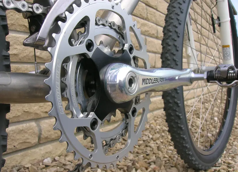

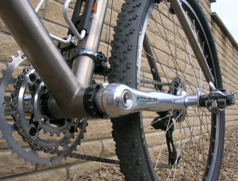

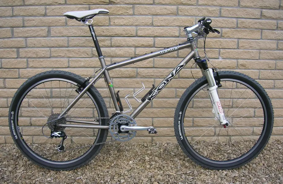

Fingers crossed this works - although it'll look crap with modern cranks. :roll:
Mike, you may be happier with a Middleburn RS8 X-Type, as they don't look quite so crap :wink:
You would be able to run 2 x 8 with a bash ring.
Pip

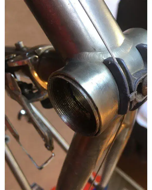

Cup fitted in - this saved applying pressure to the end of a very thin piece of metal.
Ye olde Tange item, from a now-dead 1990 Fire Mountain
Look at that crappy bolt! :shock:

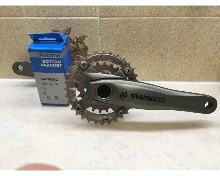

eBay comes up trumps with a set of slightly unusual, but very reasonably-priced FC-M762 cranks. I think they'll look OK. The rings are from my spares box.
For reference
FC-M739 chainset + UN51 BB + bolts = 1,074g
FC-M762 + SM-BB52 (in bolts and still in wrappers) = 799g.
So that is 275g saved!
Fingers crossed this works.... :?
SP
