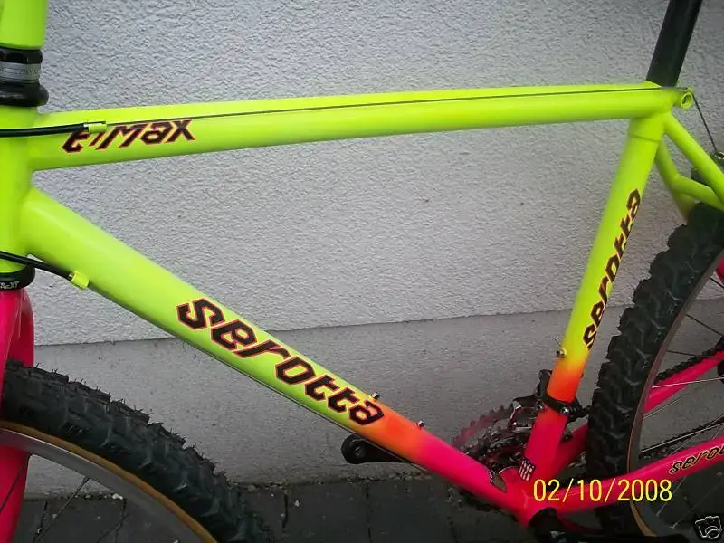

I guess this must be an example of a tapered Columbus Max seat tube, so I wonder if those with sharper eyes than mine can tell whether it's the same as a 95 Explosif?

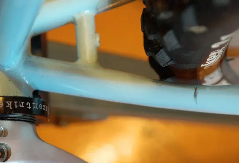

Ok Anthony, a bit more Explosif trivia.....
On the 95 frame, measured at 4.5" (108.5mm) from the centre of the bottom bracket, you get the following results.
The deformation of the stays apparently gives a spacing of around 72mm but this is only at the top and bottom of the stays. Because the inner face of the manipulated area is still slightly radiused this reduces to about 66mm at the narrowest point (the centre line of the tube).
To make matters even worse the widest point (your 4.5" reference, where I have the pencil mark on the frame) isn't where it is most needed for tyre clearance - this point is more like 95mm back from the BB centre (depending on tyre profile - squarer will be further forward still) where the space between the stays is more like only 58mm measured on the tube centre.
So, I'm using (at the minute) Panaracer Trailraker 2.1" tyres, but luckily on Mavic 717 rims they only come up at about 50mm (so just under 2.0" then). Even so, this only leaves about 4mm clearance each side.. :(
So - it's that dimension between, say, 90mm and 100mm back from BB centre that's the really important (and inadequate :roll: ) one. I'd be interested to know what that is on the '96 and '97 frames (and the later 853 ones, come to that).
A good job that I like the Trailrakers for wet conditions (most of the year then...) and that Fire XC Pro 1.95" are good for me too when it's a bit drier.
Andy.
