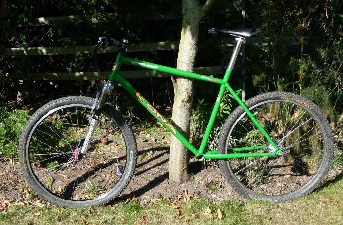

follow up so I can remember what I'm doing as I go along.
Well plans change and some Z2 Superflys with a long steerer turned up :D Which means I get to keep riding my other bikes, have ~10mm extra tube to play with while also using normal stem and headsets. :D
So put them on last night, placed my wheels and seat post from the Rocky on to this to see what it looks like and to get some ideas.
So 27.0 is a perfect fit for the frame (as would be expected)
Red is suppose to be the complimentary colour to Green, hope not as it's hard enough to get hold of some nice stuff as it is, lol.
Question though, there is a thin lip around the top of the CaneCreek S8 headset, that a very small area to be pushing down on, I've placed a spacer I have above it so I don't damage the stem though there is still a gab between it and the spacer. Is there any reason why the lip is there ?
Suns a bit bright today, think I need to pick a better place to take pictures.
Thought I'd update with a picture as it was 5/5/10, before I serviced and snapped a part in the forks.
Seat is now a Flite,
Rear mech has changed to an STX-RC mech. with XT jockey are (makes it the same weight as XT) and the chains shorter
Just so I know where I got too
KeepItSteel":396u9nxj said:
love the choice of fork.
cranks suit the frame too
I liked the fork and having a 245mm steerer helped the choice, shame I broke it but should be getting the spare part as windwave apparently have it, now they eventually replied to me.
M569-ish LX cranks with a 5 arm spider and XC Comp MD chainrings :lol:, No granny as it doesn't fit.
S 8
S 8 headsets need a specific spacer set, they come with five 4mm interlocking carbon spacers the last one clipping into the recess, ordinary ones don't work well at all.
Re: S 8
I've bought the top spacer that caps it off now. and grab another for it to tune it a bit.
Still might swap it out for a Ritchey WCS, not too fond of this one so far.
