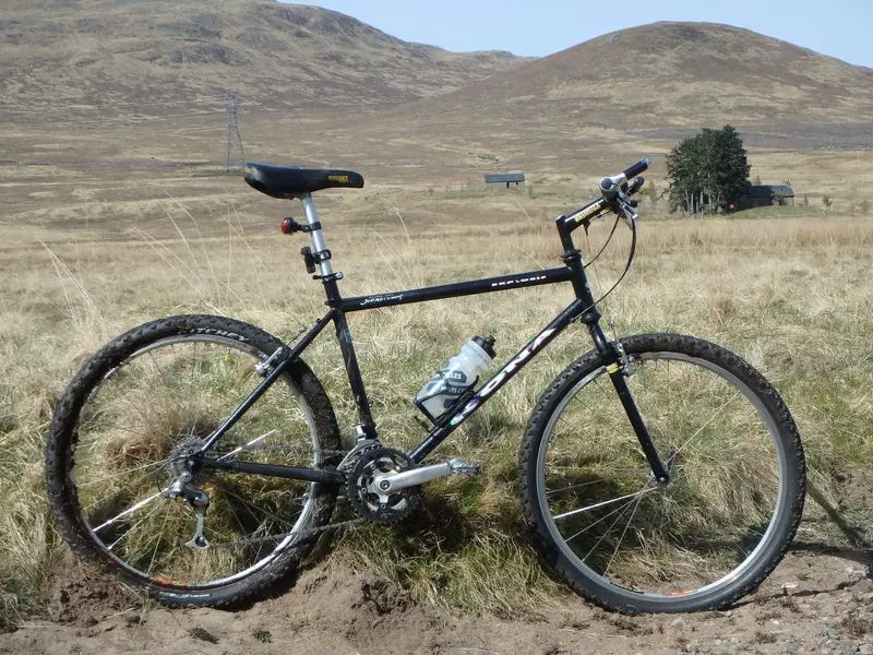

Pics as it was:

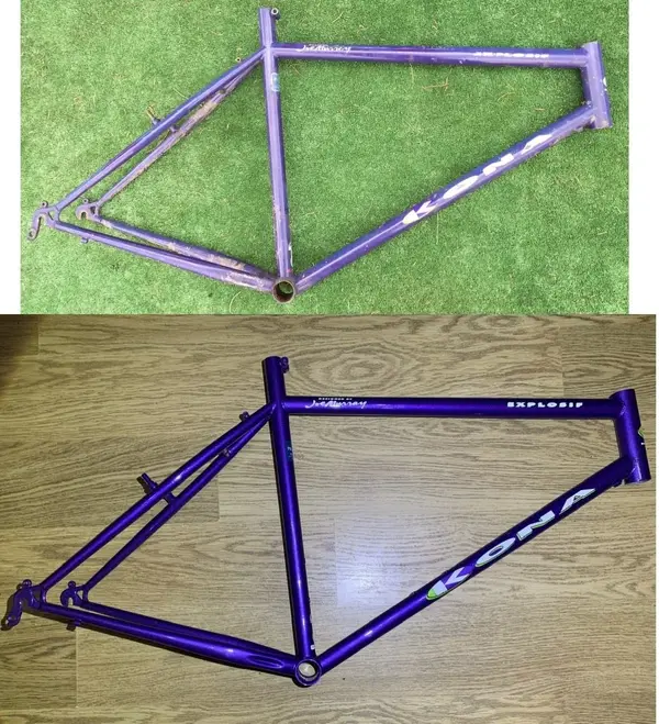

Nice bike u have there
The black looks smart.
I’ve the same frame with paint that was past it so got it redone

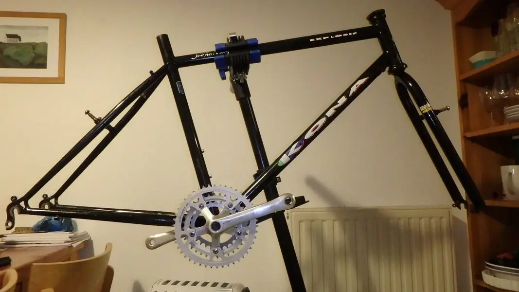

BB fitted. Tange Seiki 7922. Light weight and supposed to be good quality (fingers crossed).

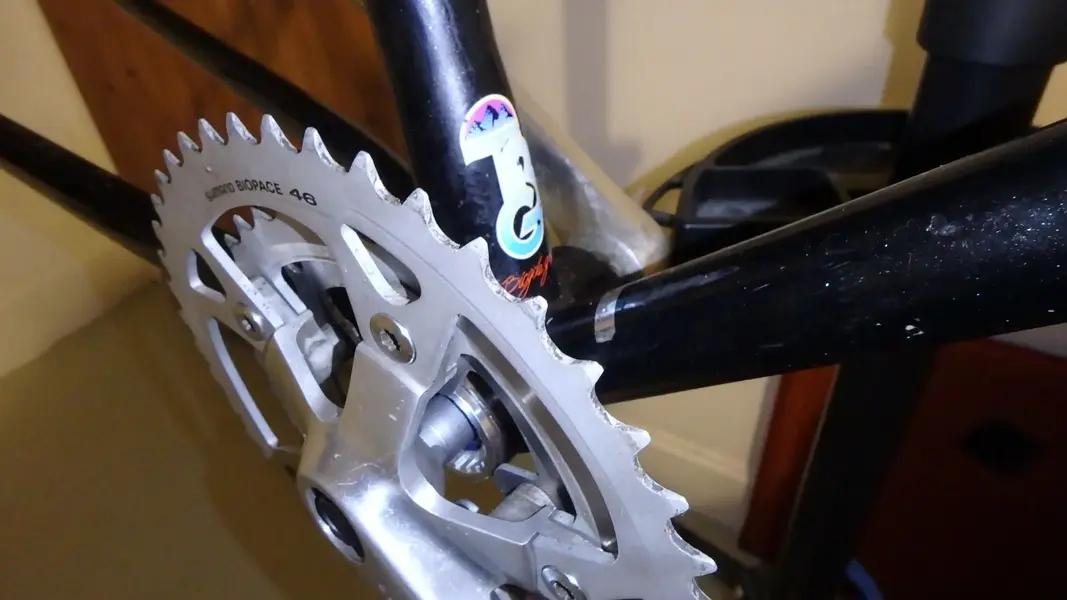

Cranks on - M730.
Headset fully fitted and forks on. Definitely smoother without lower half of the Impact headset. Time for beer and fodder.

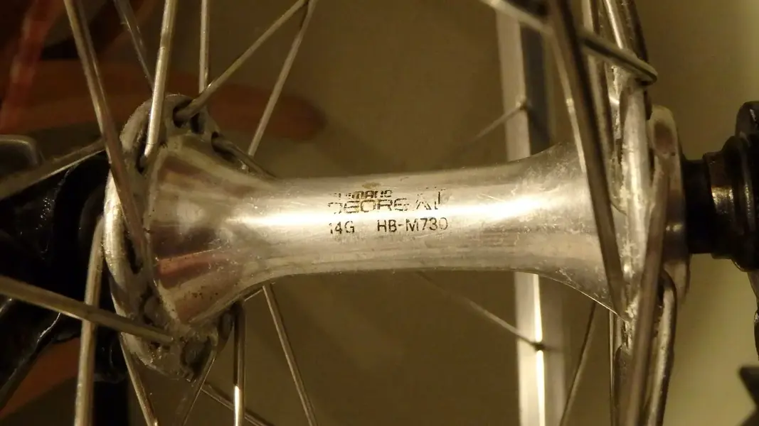

Hubs: XT M730/M732. I won't polish these as logos are already vanishing and then I'll forget what the hell they are. Patina and wrecked logos will match the frame so entirely in keeping. And they run nice and smooth : )

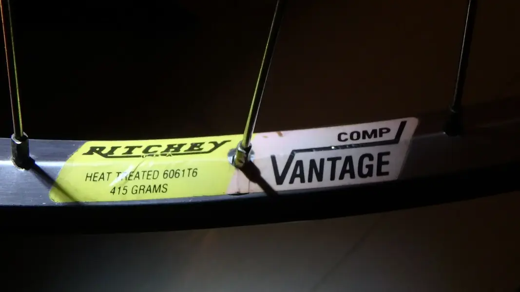

Rims: Ritchey Vantage Comp in nice condition with faded logos. In keeping with not dressing mutton like lamb.

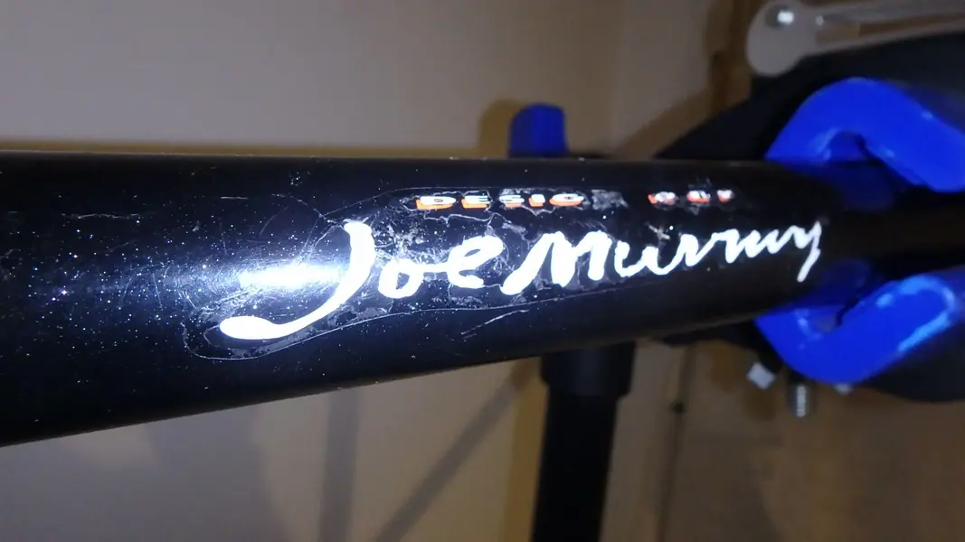

Bar and stem on. Logos a bit rough but I don't look quite as I did 28 years ago either so they'll do fine. Bit of rust treatment needed on fasteners and cable guide.
