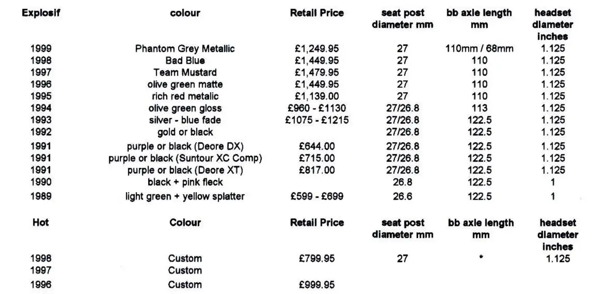

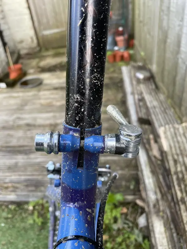

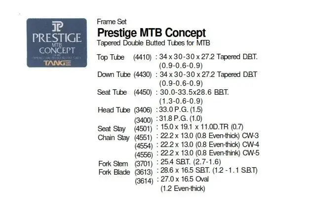

The other slight concern I have is the seatpost size. All documents indicate a 26.8 seat post. Even with a beer can shim it feels too loose to me. The cutouts looks to be tapering too much for it to be a 26.8. I think a 27 wold be too large. What do you think? (26.8 thomson post)
