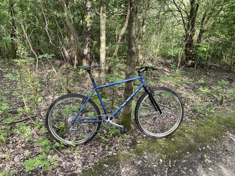

This bike still lives. After sitting for a year unused at the back of the garage (house move and work got in the way) I dusted this off. Stripped, re-greased and re cabled the bike. Built my first wheel. Then took it for a shakedown ride through the park.
The spec has changed slightly from last time. M900 xtr rear derailleur
8 speed wide cassette
M231 rear rim.
Avid v brakes.
30C583AC-DB56-4821-A789-1A29BB279E9E.webp 32B15267-D692-41F6-A587-7631B2E405D3.webp
It’s definitely not for the purists but its such a fun bike to ride. The new additions make it more usable for me. I need to improve the chain line. Anyone have ideas how to do this? I have ordered another bb with narrower spindles to see if it helps.
The other slight concern I have is the seatpost size. All documents indicate a 26.8 seat post. Even with a beer can shim it feels too loose to me. The cutouts looks to be tapering too much for it to be a 26.8. I think a 27 wold be too large. What do you think? (26.8 thomson post)
