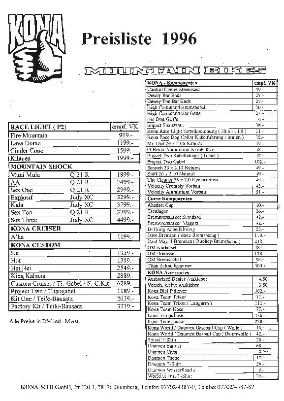

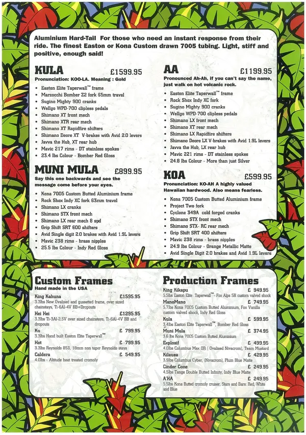

I was wondering the exact same thing. What helped me was an old Kona catalogue scan. You can use it to figure out the value scale of the frames. The tricky part is that some are listed with the rigid P2 fork vs "mountain shock" and "Kona custom"
This one is a little later, less comprehensive.
Also consider you're looking at a 1996 dealer price RRP and 1997 consumer RRP which can be two very different things!
As a general rule, Fire Mountains, Lava Domes and Cinder Cones share the same frame geometry and tubing BUT this does vary across some years and certainly more so after '97. The Hahanna's have a different and more relaxed geometry and usually have lesser grade chromoly tubes.
The other general rule is FM's and LD's would come with CM P2's with CC's TB P2's aka "Race Light". You had a similar variation with those fitted with front shocks aka "Mountain Shock" although it's fair to say, all suspension options fitted are horrible until '98.
Kona Custom was just that. If you had the money to get some of that, you probably weren't buying a FM, LD or CC...but that's just my opinion :wink:
