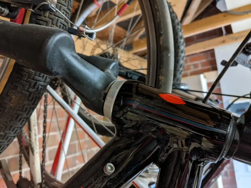

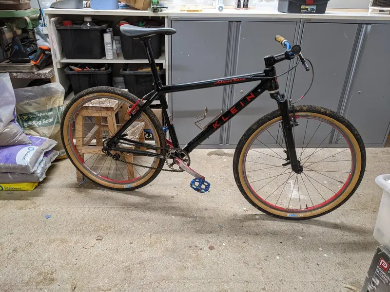

If its anything like my 2000 Adroit Race, the usual Klein adapters won't fit. According to my email history I bought mine from a guy called David Giessel back in 2011. I can't find any more info on him and his website (themacaddress.com) no longer works.
He said I've got an MC3.1 setup - a tapered steerer where the top section is about 1 1/4.
Looks like http://reset-racing.de/ do a full headset.
This is what mine looks like.
