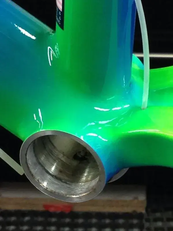

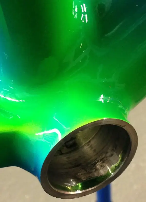

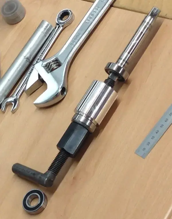

Few more ti bolts ordered for here and there, bb removed-all as expected in shell, new bearings and original Klein Bicycles ti axle ready for fit, tomorrow possibly time depending.

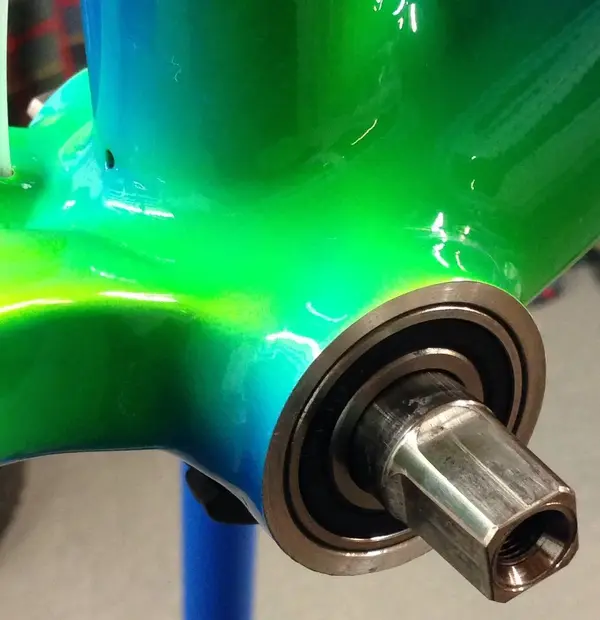

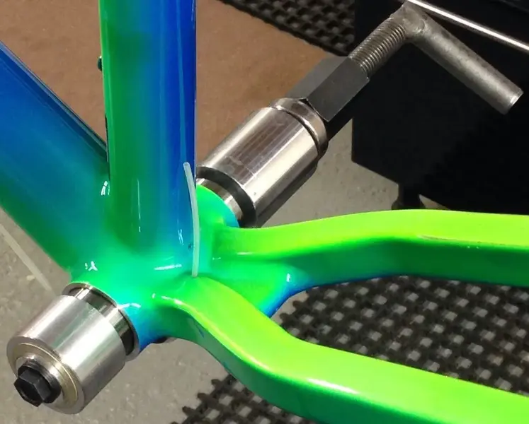

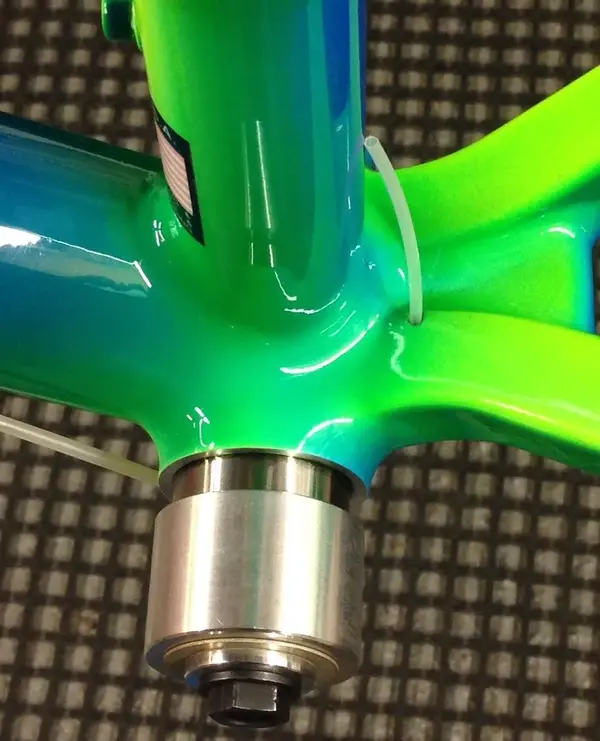

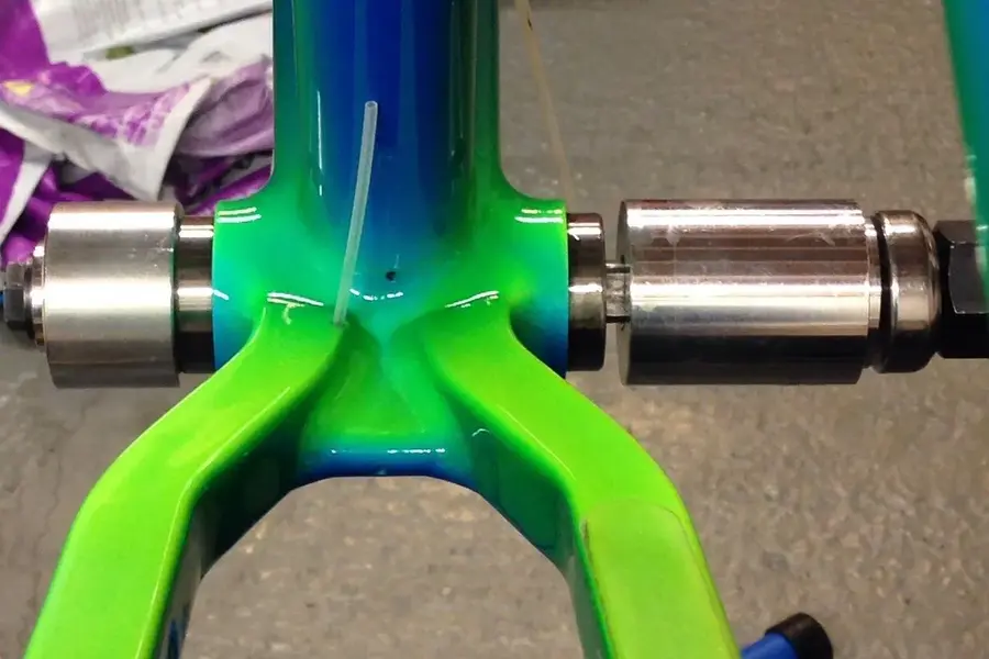

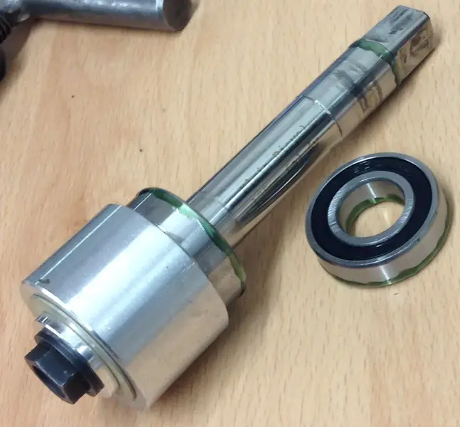

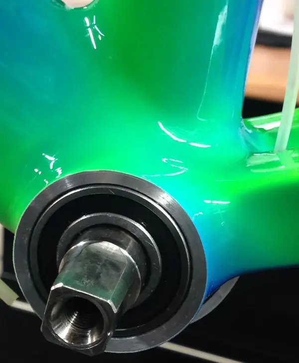

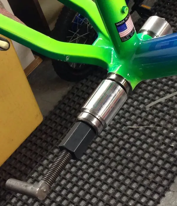

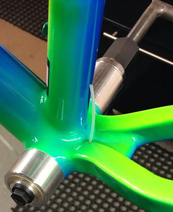

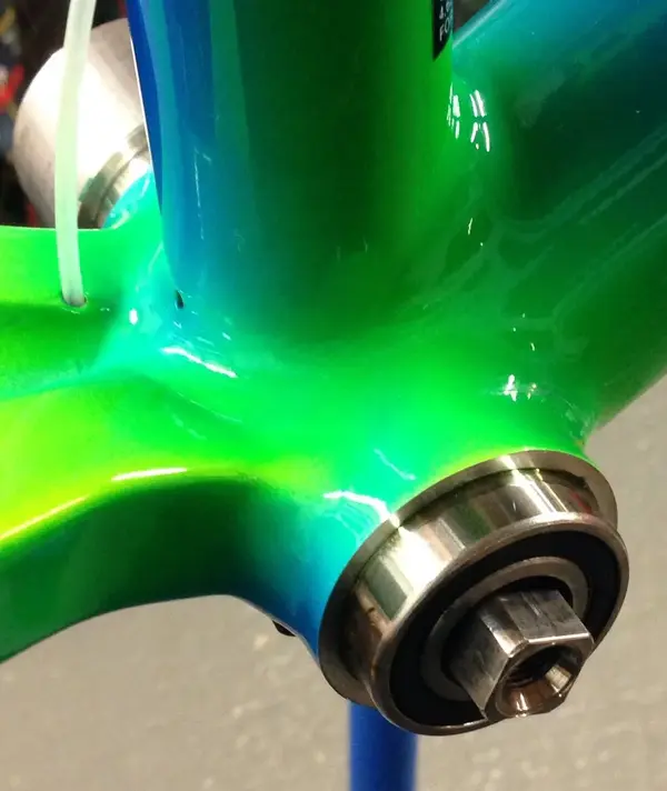

Bb installed this evening, perfect. 8)

Bb pics.

It would have been really cool if you would have made a how-to video on removal and installation of the BB.
Thought about it a few times, I did find a detailed photo step by step guide on the net once somewhere so left it, maybe one day I will.
