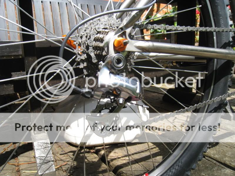

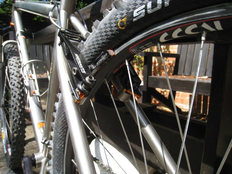

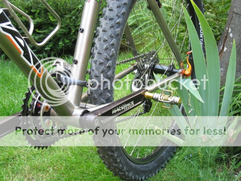

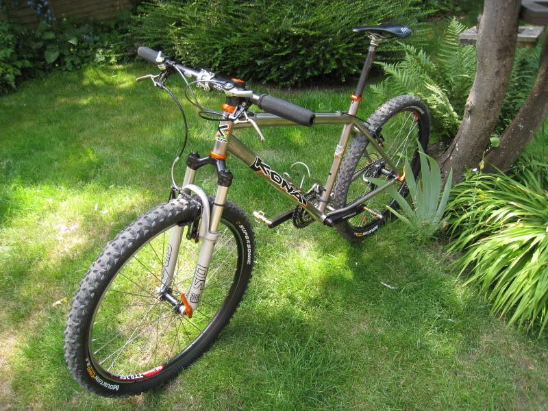

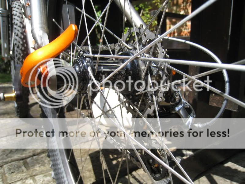

Now re-built with lightweight components but still kinda 'retro' I think with thumbies and V's ;) :) All components weighed before assembly.
Spec:
Frame:......... 18" 2000 Kona King Kahuna...1657g
Fork:........... '08 SID Race Dual Air 80mm 450mm A-C...1287g
Headset:.......Cane Creek 100 (King Quality!) - anodised orange...104g
Stem:...........Ritchey WCS 100mm...135g will be Syntace F99
Handlebar:....USE Atom...132g
Grips:...........Extralite...32g
Barends:NA
Brakes:........Extralite...94g front + 93g rear inc. pads etc
Pads:...........Extralite
Cables:........Gore Ride-on...76g
Levers:........Extralite...62g
Shifters:......Pauls Thumbies with Dura-ace levers...139g
F' Mech:......XTR M952...112g
R' Mech:......Dura-ace short cage with KCNC jockeys...182g
Cables:.......XTR...58g
Cassette:....Dura-ace 9spd 12-27...178g
Chain:........KMC 9SL...230g
Cranks:......Race Face Turbine Isis...596g
Bolts:..........Race Face Isis...28g
Rings:.........Race Face 42,30,20...inc.
Bolts:.........Alloy - orange...inc.
Bottom Bracket:..American Classic Isis...153g
Pedals:.......Crank Bros Eggbeater 4Ti...167g
Hub Skewers:..Salsa Ti - anodised orange...82g
Rims:.............Stans 355
Hubs:.............Tune Mig/Mag....Wheels:589g Front + 712 Rearg
Nipples:..........Alloy
Spokes:..........Sapim Blade
Tyres:............2.4 Mnt King S'sonic or 2.3 Speed King S'sonic...922g
Tubes:............Bontrager SL...248g
Saddle:...........Sella Italia SLR...145g
Seatpost:........USE Alien carbon...147g+21g (shim)
Seatpost Binder:..Thomson - orange anodised...27g
Bottle Cage:.....King Titanium with orange alloy bolts...29g
Weight: 18.6 lb / 8437g with Conti Speed Kings :)
I've SID World Cups with black and with white lowers - need to decide which colour will look best :lol: and will do a custom job to reduce weight a bit more.
A few Pics ;) ....
