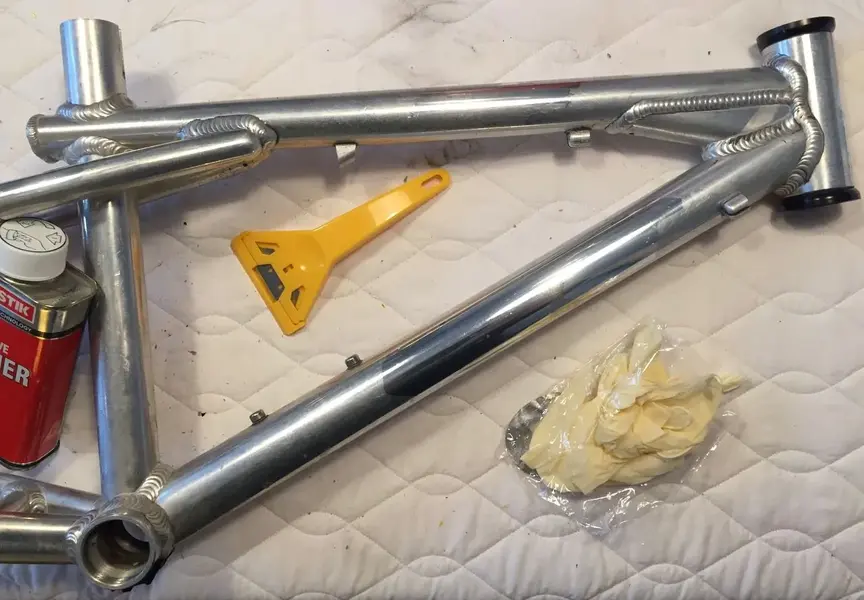

Cleanup has started. Any tips on polishing this bad boy? Planning to use wire wool and Autosol mainly. Perhaps a soft wire brush dremel attachment for the welds?

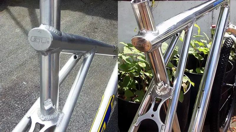

i can highly recommend my prodecure: wet paper 1000 all over (if necessary 600 in some spots perhaps), next step belgom alu (that's the stuff!!!!!) with drill driver and very very soft polishing buff a plus luster laces for the corners (behind bb etc.). finally handpolishing with some polish wadding and belgom. last step is cleaning with either rinsing water or brake cleaner spray (car stuff). latex gloves are quite useful :lol: to cover the gloss (i've been told) a product called liquid glass shall be exhilerating :wink: suuupercool project btw.
