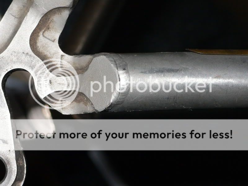

From the few pictures posted, it is clear there are multiple issues with this frame;
The first being the torsional failure extending from the bb area up and around the bottom of the down tube, terminating on the drive side. This fatigue failure should have never been welded along the failure line, as torsional propagation cracks will continue past the end weld. The proper repair for this failure is the replacement of the down tube.
The fractures at the seat tube/bottom bracket are typical for the manufacturer along many of their clients lines. Poor miters and insufficient purge have been evidence in the years following, an unfortunate result of their rush to jump into the Ti market during the 90's. While this area can be easily repaired, the contaminated welds on your frame indicate that it was not done correctly. These oxidized welds will fail again in time due to the excessive heat and poor purge coverage.
The dropout in question suffers most from a poor design, placing all the torsional stress of the dropout on a hinged end plate. It broke at the weld as the design does not transfer the stress to the strongest point of the joint. The interior of the tube shows high oxidation levels...from a repair standpoint it will be very difficult to properly clean this section before welding. The correct way to repair the dropout would be to remove it fully from both stays, bead blast the interior of the tubes, grind away the existing weld, and extend a custom machined insert from the inside of the chain stay to attach more fully to the surface area of the dropout. This will allow for greater torsional rigidity and longer dropout life in cyclic stress loads.
Could the frame be made safe again? Yes. Replace the DT, BB and modify the dropouts as noted.

Another photo' to show the joint 'closed' so you can see there is no material 'missing...'
A very simple repair indeed... As for the assertions that the tubes should be replaced, I beg to differ;
If I wanted to ensure that the BB area was as strong as it could possibly be I would cut the down/seat tubes, insert a slightly smaller diameter tube (push it into the upper part of the tube then let it drop back down to the BB when you close the join) to over lap the damaged/cut section, drill it, pin it and then weld up the joins - job done... :wink:
With respect I think that you're missing the point of Rody's advice on what constitutes a safe and quality repair.
Sure you could add extra inserts, pins, plates, gussets, welds and whatever else to make the frame virtually indestructible, but at the same time you could double it's weight and kill any ride characteristics.
There is a big difference between aircraft engineering and bicycle engineering, and while I wouldn't doubt the skills, experience and knowledge of an expert in that specific area, I would also hesitate to undermine the input of somebody as skilled, experienced and knowledgeable as Rody is in his.
