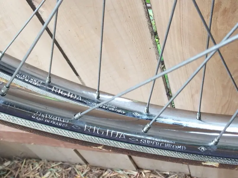

wheel rims appear they may be RIGIDA SUPERCHROMIX
if this is the case they may exhibit a date inside a small diamond symbol near the name as here:

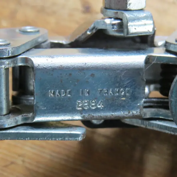

the cycle's Huret Svelto gear mech will express a date marking in the form of a four digit number, a practice which commenced in 1978
it is relatively late production as the Svelto launched in 1962 and this black trim edition did not launch until the late seventies
the first two numerals of the marking indicate the the week of the year and the second two the year as in this example:
