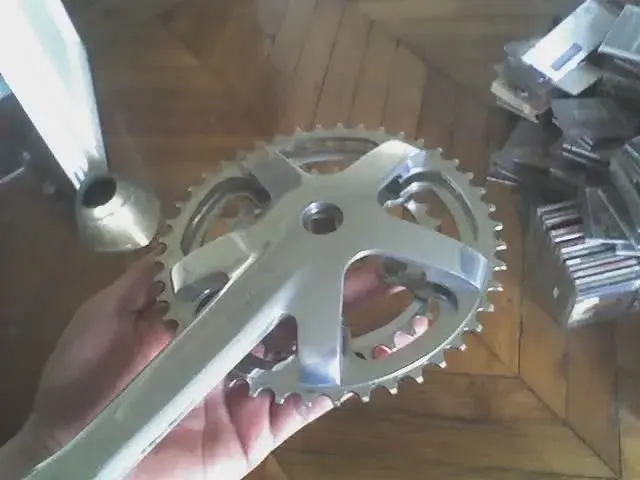

These are my favourite Mavic cranks, the later 631/2 model. You can run a smaller big ring on them: 44t minimum, as opposed to 48t on the original 631.
One of these days I may try for the "Tout MAVIC" build, but those cranks are destined for a novel half-step-and-granny experiment. The rings are TA: 44, 41 and currently a 32 that will probably get swapped for a 28 or 30.

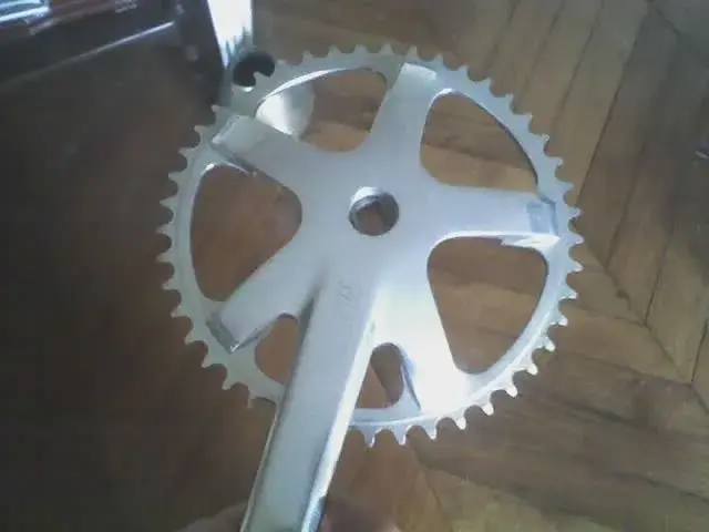

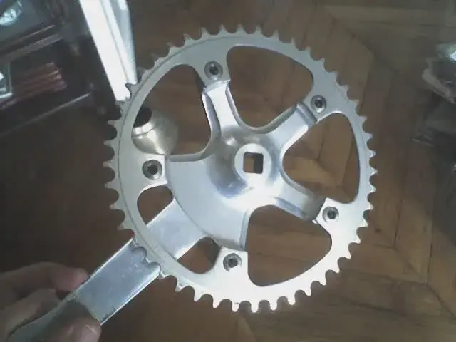

One really nice thing about these 631 series cranks is that you can remove the double chainring mountings and bolt a single ring straight to the back of the spider. Mount them on a Chorus or Record 102mm bottom bracket and you've got a super-low-profile track crank.

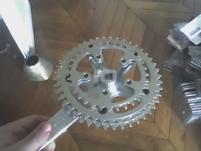

Put the double mounts back, and with either the Mavic triple adapter or a TA adapter chainring, you've got a low-Q triple. This one's set up to run like a 2x9, with the outer chainring added to half-step an 11-32 cassette.
44 41 30
11 12 14 16 18 21 24 28 32
