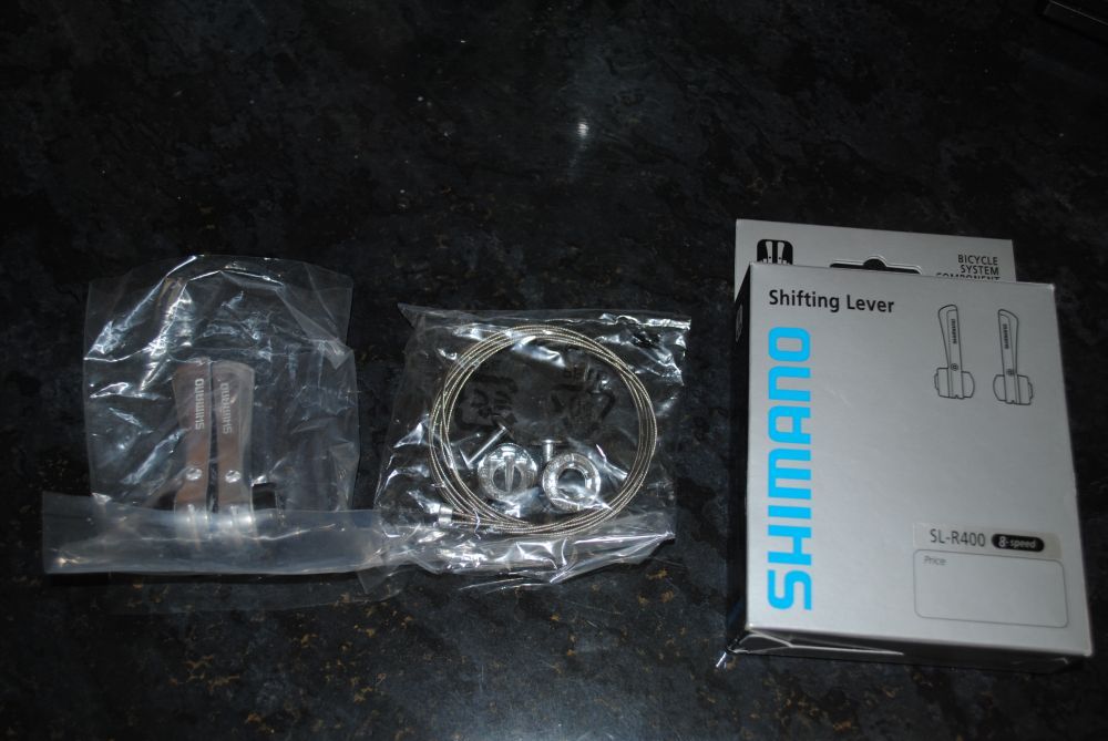

watching a set of 8sp down tube shifters on evil bay.
