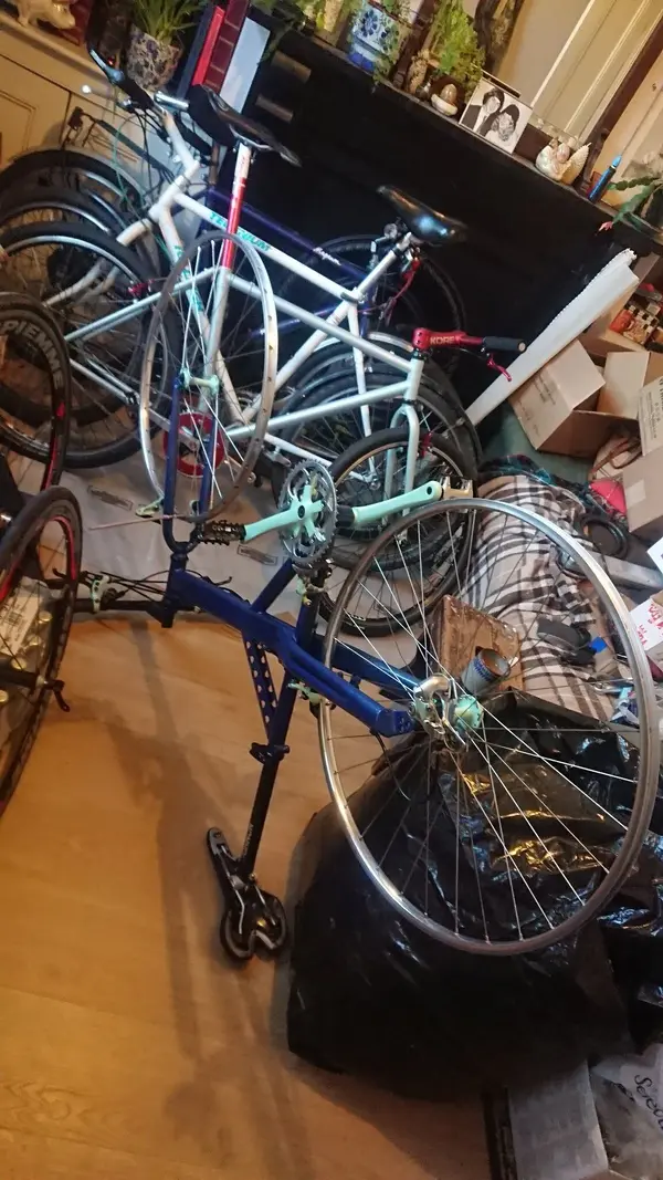

I've fitted the TA Specialites middle and outer and original granny that were on the cranks when I bought them. I might need to change them once I get a feel for the gearing.

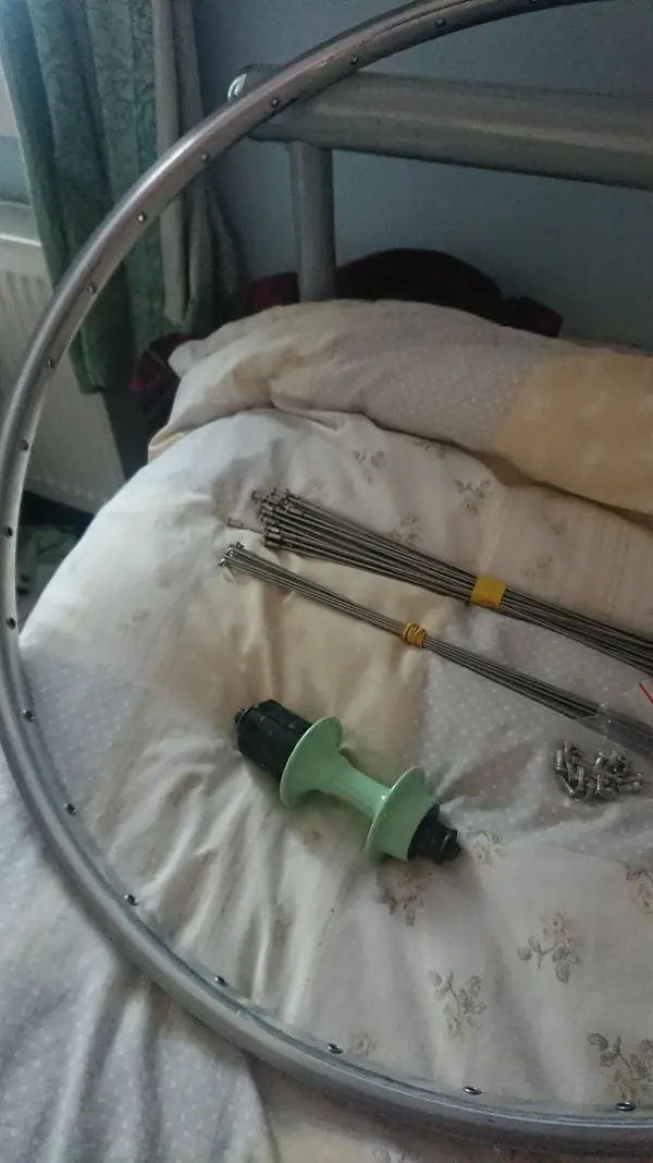

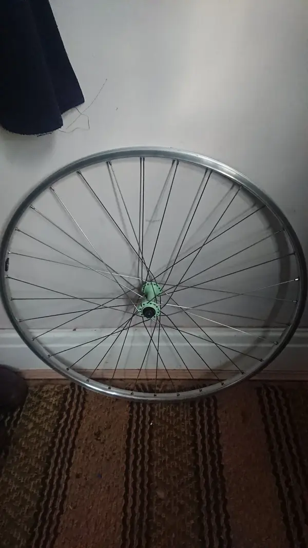

Thank you! I won't promise to finish the whole bike today, but I will finish the rear wheel for certain. Currently 16 spokes are in place.
I'm wildly impressed when people put whole projects together in a matter of days. I know I can do that in the absence of other commitments but that's not my life! So, it's a great relief to watch thoughtful, top quality, slow-burn builds coming together at a pace that still exceeds many of mine. Today, next week, month, year... whatever. It's the process that's important. One spoke, one wheel at a time 👍.

Rear wheel looks good 👍 . Frame looks good.

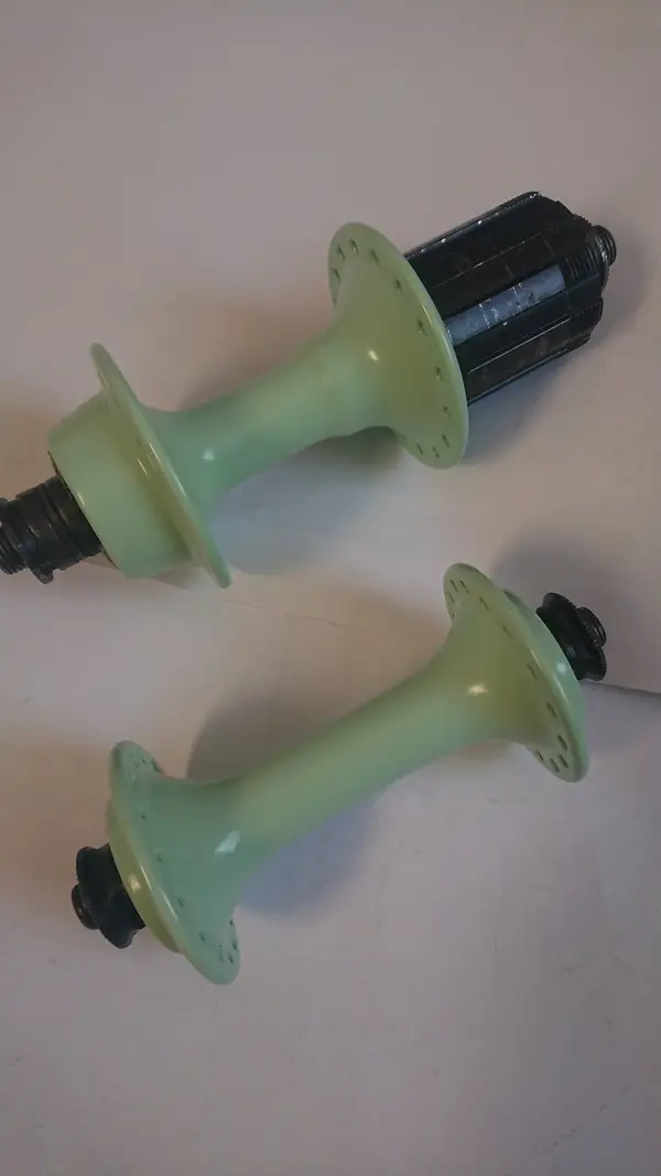

I had assigned a cassette to this project, but that was a while ago and I don't remember which. No problem, I have a new 8 speed Miche Primato I bought recently ........ however, when I fitted it on the m900 freehub there is some play, as it is not quite as deep as the freehub. I'm missing something here. I found an old, dirty Shimano 8 speed cassette and that fits the freehub fine. I've checked the Miche cassette and I'm not missing any spacers. It looks like the Miche is sitting further onto the freehub that the Shimano one.
Tried the Miche on a Royce hub and the fit is fine. So is it wear on the m900 freehub or just compatibility issues?
Should I fit a spacer to the freehub before the cassette or wait until I can go to my storage to look for whichever cassette I originally panned to use?
