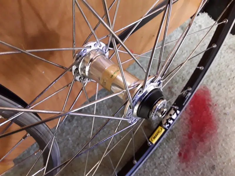

Wheels, easy, straight off the wall. Mavic 317xc with 737 xt hubs (actually built for this bike in the first place). This will allow me to graft on some 8 speed kit which ive also got.
