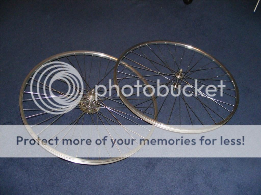

The wheels are Rigida Rush rims on Pelissier hubs which came from a boot sale, I am waiting for new spokes to arrive so that I can have a go at rebuilding the old wheels (Fiamme rims on F.B. hubs, cones on the front hub date-stamped 1949)

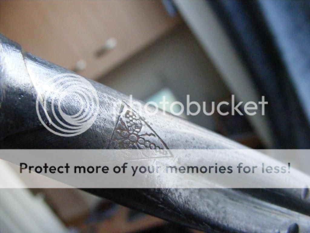

Interesting dragonfly logo on the chain-stays I have read about this mark, but no-one seems to know what it means.

I have now discovered that the dragonfly logo on the chain-stays is the trademark of "Libellula" (italian for dragonfly) tubing manufactured by Castello Mario & Figlio of Torino, Italy during the 1950s.
