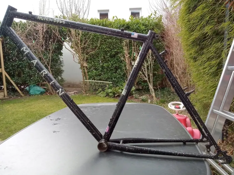

I have a Marin frame (and a bucket full of parts ) that has been a bit of a puzzle to put a date on, I think because it has a continental Europe paint scheme, perhaps specs too, and so doesn't show up in catalogs I've found or google image searches for 1989 Marin Muirwoods.
Can anyone confirm that it is indeed a 1989?

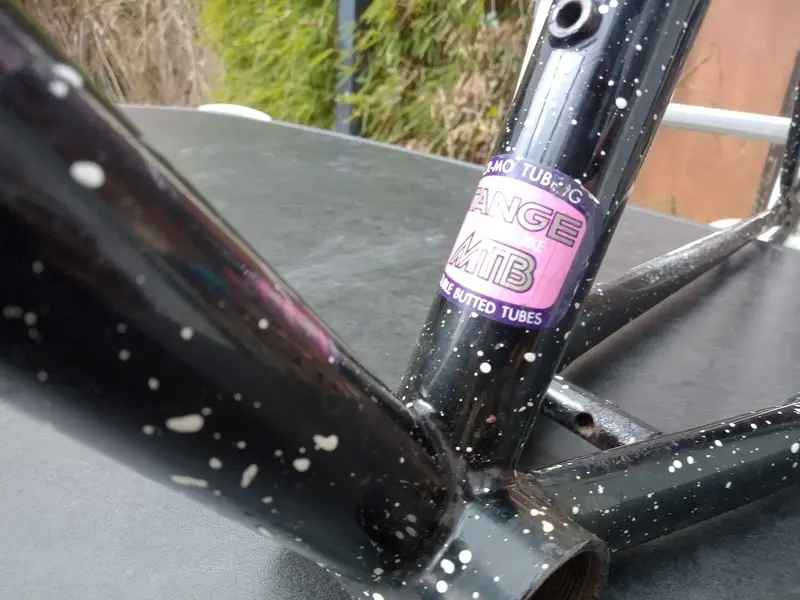

Here is what I know: it's obviously a Muirwoods, with white splatter on black base coat, with green decals, now faded. It came with a mix of Exage Trail and Exage Country date stamped stamped Nx, so 1989 on the components.
The Serial number is not entirely readable, but the important bits are there: M90....6. The very helpful 1980s Marin ID thread here decodes this as Marvel 1989....Model 6 (Muirwoods).

Got a better look at the serial number on my frame, it starts M907, so that would be July 89.
The serial number from the frame with the U brake is M903, so maybe there was a switch mid year....
Yes, i would concur with 1989.
The exage stuff, the decal half way down seat tube and the rear cantilever brake arch thingy just about says it all.
