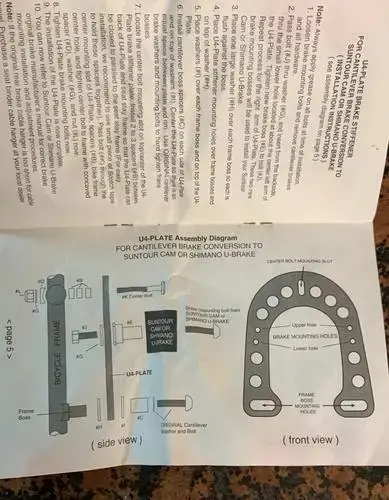

As Fluffy Chicken mentioned a few times, Odyssey RJ's (whoever they were) U4 Stiffener Plate, is designed for this. You'd need to complete kit including all the hardware. Which isn't common.

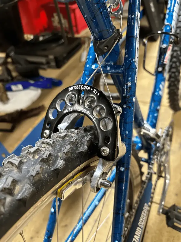

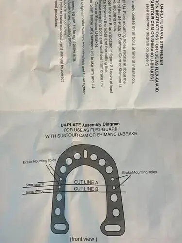

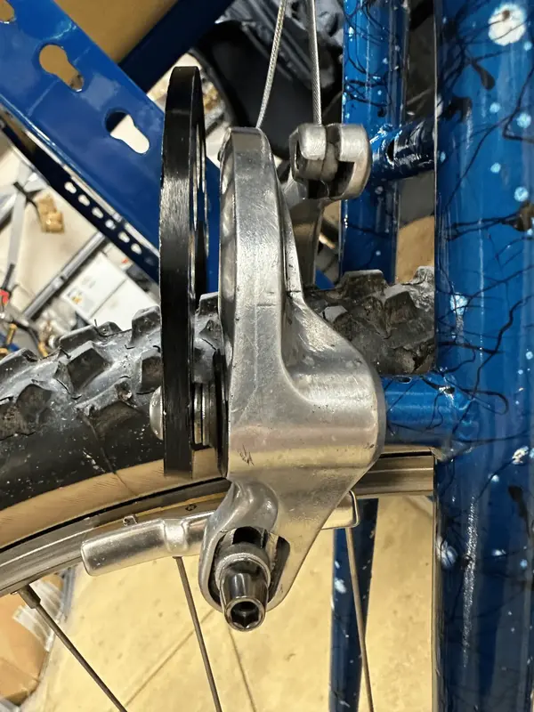

I've recently bought an Odyssey U4 to use as a brake stiffener on a Shimano U brake. It was like a 4 in 1 kit with tons of hardware and options, I only got the plate part though.
To use on U brake you have to cut it, had to widen out the mounting holes slightly. Works well it does too.

I just had to bodge my own hardware. Used some longer stainless bolts. Looking at some nice black anodised aluminium spacers instead of the washers.
