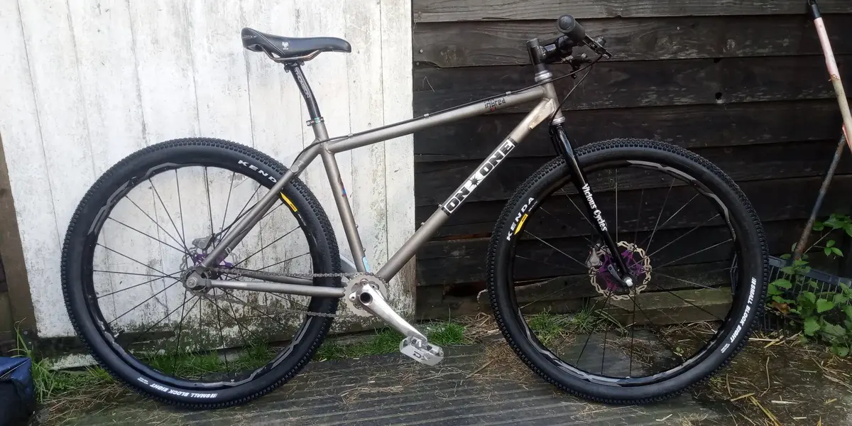

IO, IO its off to work... Now a Ti Inbred.
Been using this quite a bit recently.
Picked up a lovely pair of Mavic Elite XA 27.5 Boost wheels for it surprisingly cheaply. Bit of tweakage and they are in, front runs a smidge off centre.
Lighter than the old tubeless wheels even with tubes in as i didnt have any sealant left.
Anybody know where i can get a shimano freehub for it from?
100/135.
Adaptors off the interweb and a couple of small washer type spacers to get them in and discs on correct alignment then redish the wheels to centralise the rims.
It only happened as i saw the wheels advertised really cheap and I like a challenge😁

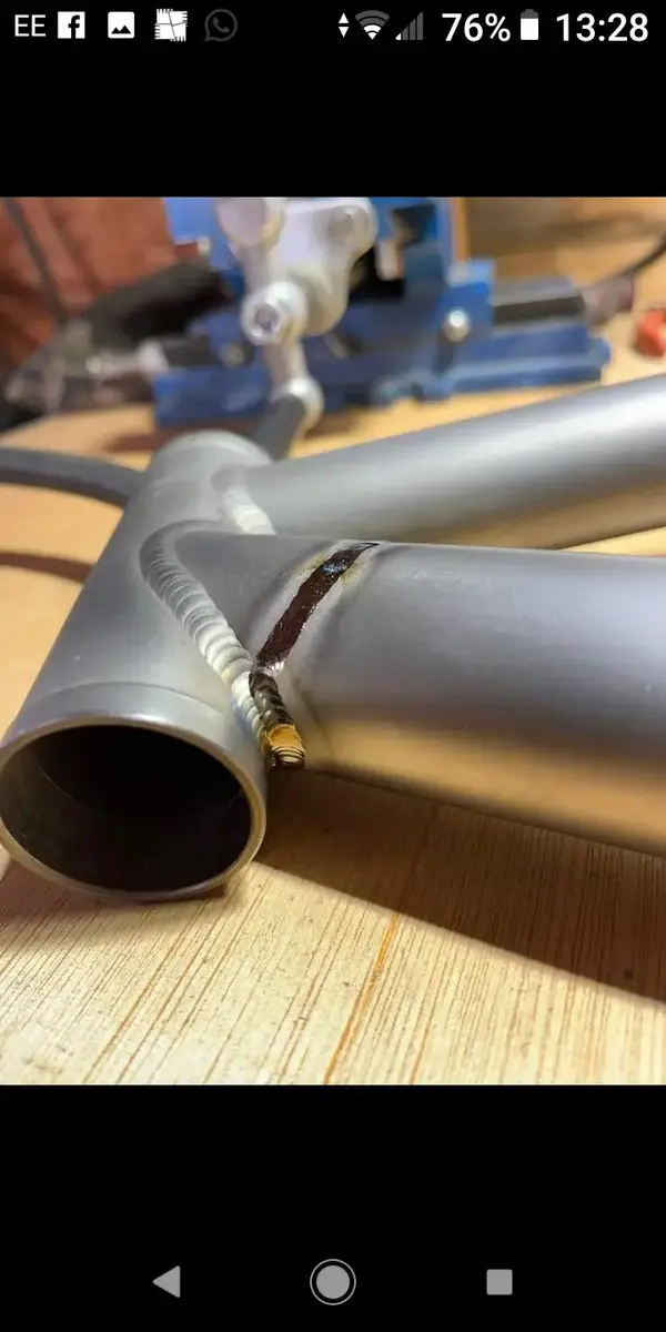

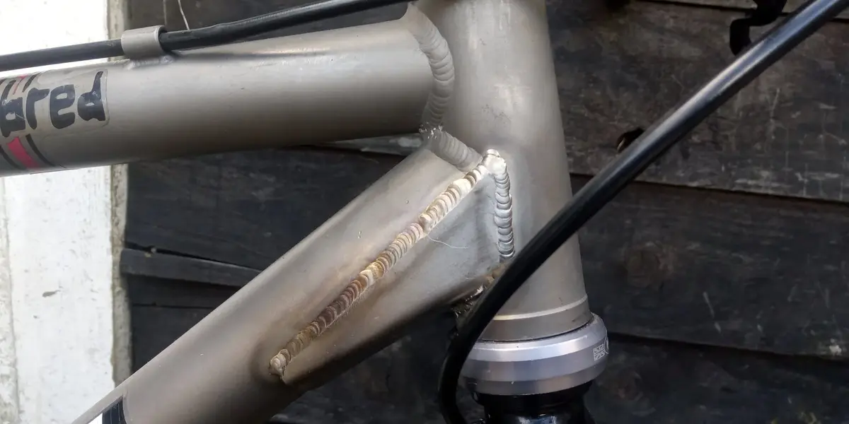

Thread resurrection time!
Around the time I initially built this I bought a badly cracked On-One Inbred Titanium 1999(? First run).
Fast forward 10 years and I finally got round to getting a good mate to weld it up for me adding a gusset for a spot of reinforcement.
He's made a great job of it.
So I've now swapped all the bits over including the 27.5 Boost Mavic wheels I persuaded into the IO frame.
