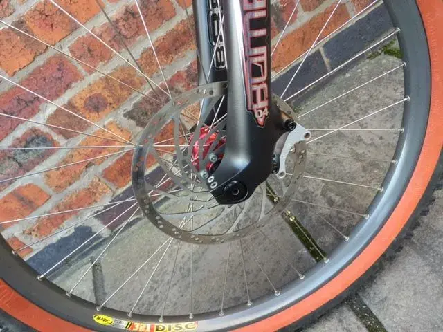

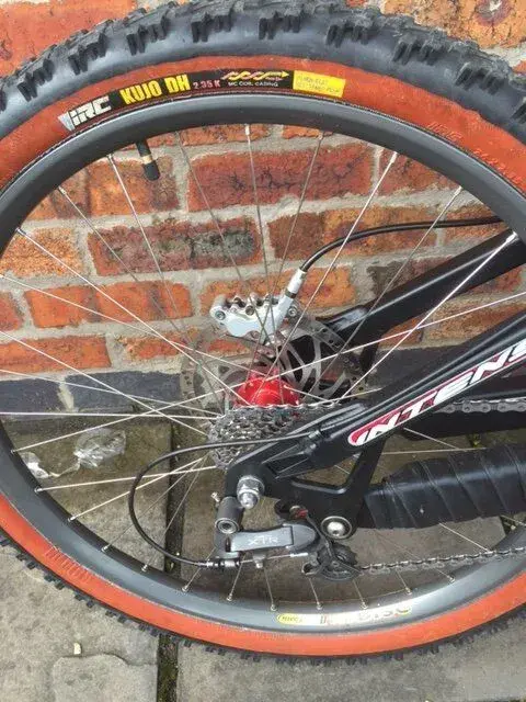

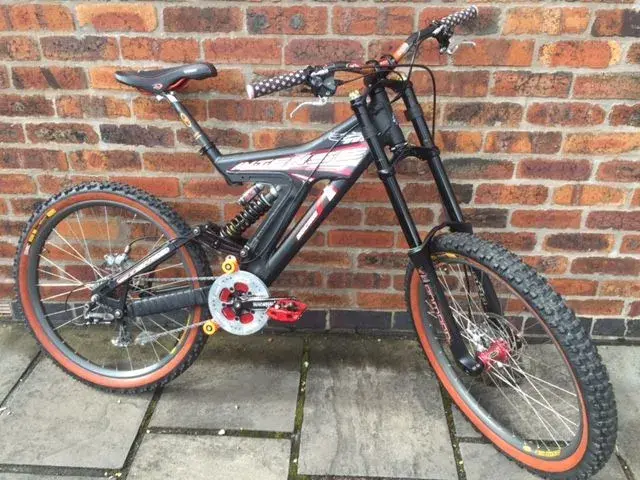

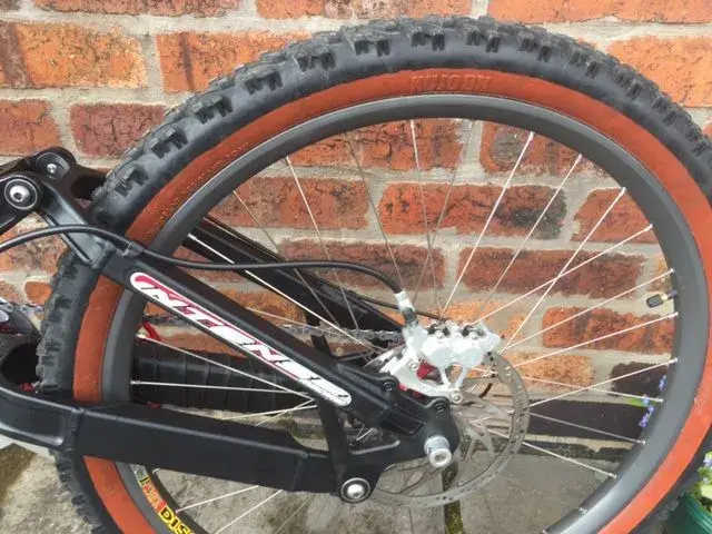

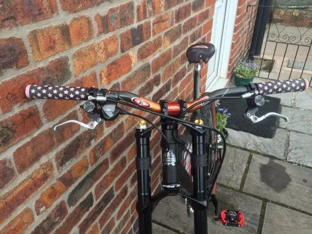

So a few changes from my first initial rough build changed the bars and seat post to easton, found a titec berserker seat in the cave,xtr short cage mech, durace 24/12 cassette, went for the 12mm bolt through as this was the set up of the hope bulb
mounted the discs but needed +20 adapters as my callipers are no.3
all cable and chained up, my hope endure 4's where completely shot, currently having a full strip down and rebuild

Looking good - personally I'd try and hunt down some crowns from 2006 888's to lower the front end a tad. The early 888's were long and not helped by the drop crowns.
My old Demo 9 must have felt like something from American Chopper with those forks, drop crowns, a 10 degree rise stem and 50mm rise bars. My current demo 8 front end feels high with flat crown 888's, no rise stem and flat bars. Things have certainly changed since I was last playing around on big bikes!

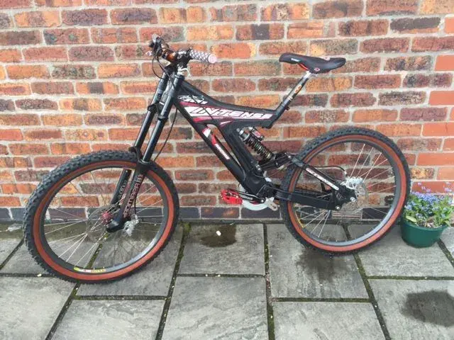

Thanks for the positive comments, really wanted to fit Manitou Darodos, but couldn't find any in good enough nick, these 04 888's came up from this forum actually, in excellent condition, jus stripped the legs n re-stickered them, they are tall though! It's been a while since I've ridden anything so bouncy!! :twisted:

So its been a few months and finally got the Hope E4's fully rebuilt and fitted, they needed new callipers and seals! :facepalm: they are now fully sorted, had to put new bushes on the 5th Element, the M1 is ready to rock!! I've been out for a quick spin and its bloody heavy (44lb :shock: ) but not done any proper gravity work yet, even found my old Bell Bellistic helmet, bit gutted its finished actually as I've enjoyed building it, next!!
