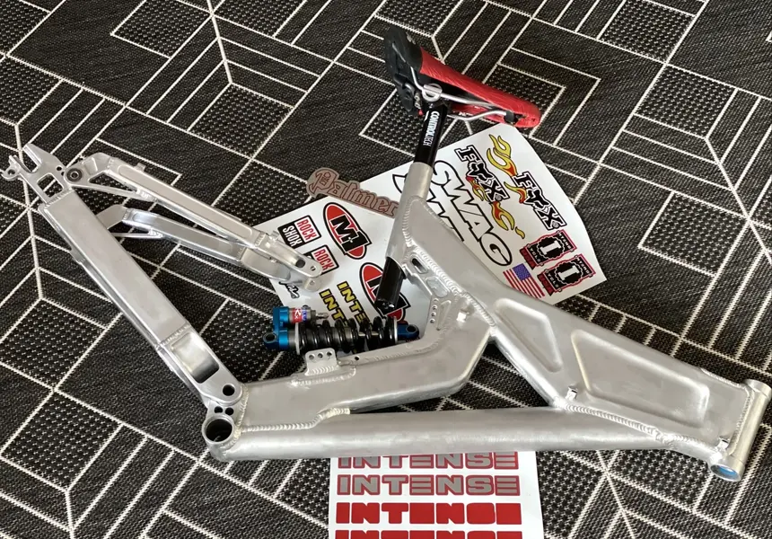

Last spring I found a cheap 1998 Intense M1 frame here in Finland, and got it without yet knowing what kind of project I should turn it into. Then after some time I had a flashback to one of the most iconic bikes to me which I remember first seeing in Chainsmoke movie ridden by Palmer - The black and red M1 with the swag/fox/spy etc. decal set on it. Back then it was a special proto type of frame, but apart from the slightly different chainstays, a bit heavier headtube/seat tube reinforcements and the four holes above the shock (two in production models), they're pretty identical with the 97/98 production models. At least I can live with these differencies 😀

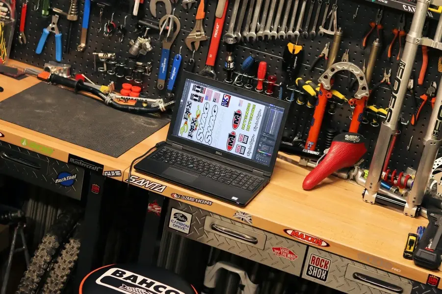

During Autumn I also started drawing the decals based on the old photos, and found out that there were a total of 16 different decals on the frame plus the special decals on the rims and fork 😂 So it took me months to draw them on an old Illustrator that I got from a friend, half an hour here and half an hour there, and quickly it was December when I finally dropped the drawings to my friend who has a professional printing shop and helps me out every once in a while. The decals also include some foil stickers, and in this case two layer decals, so it needed some special printing jobs also.

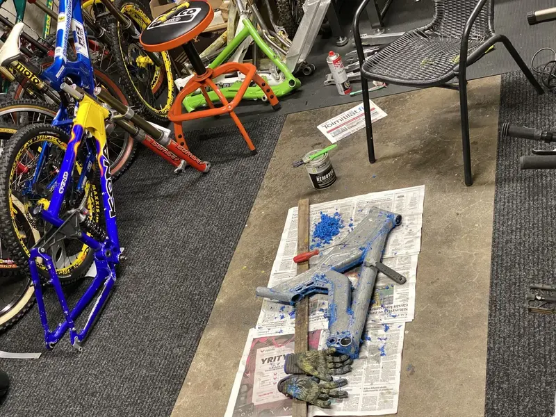

The frame work is never my favorite thing, but I want to do as much by myself as possible, so I usually do the paint removal and surface finishing manually. Like most of us I have to work the days and take care of the family after that, so I only got small time slots for these dirty works. So again this took me some time to do properly.
I just managed to finish working on the frame this week so next step for me is to walk into the car paint shop, scroll through the paint samples, choose the fitting colors and drop the frame to my painter friend at some point!
