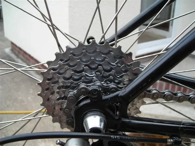

I recently replaced the chain again on my '91 Cinder Cone, but cassette was still fine so left it alone.
But, the indexing is proving a real nightmare. On the few rides I've done with the new chain I'm getting a metallic sounding noise from the cassette / RD / jockey area when in the fourth sprocket. When looking at the chain / sprocket relationship while up on the workstand, the chain is definately making contact off centre of the sprocket. However, when I adjust the noise away via three or four anti clockwise turns of the barrel adj', I then get the same noise on the first & second sprocket... :evil:
And vica versa, everytime I adjust one away, the other starts making a noise... just don't know what to look at next? I'm only doing one turn at a time on the barrel adjuster, so its not as if I'm overdoing it the other way.
Buy a new cassette (7spd Shimano HG) even though the other looks fine? Or hit with large hammer out of frustation and hope for the best? Or any other ideas?
Check the cable is clamped right and you haven't taken it the wrong route (easily done). Always set indexing with the smallest two sprockets - if they're right and it doesn't work further up the block there's a cable problem.
I'll check cable routing tomorrow, though it doesn't have a separate hangar - RD bolts straight to frame. I did think it might be a RD alignment problem, but just looking at the mech from the back, it looks OK, at least to the naked eye...
Is there any way an LBS can check a frame for 'trueness', bearing in mind that if there is an issue we must be talking microns...???

I've checked the following:
1. Cable - no kinks and routing seems OK at the back i.e. no sharp angle as it enters RD, though maybe there is a little too much outer between shifter and 1st cable guide (see pics).
2. Jockey wheels spinning OK and pins/bolts tight.
3. Chain is a 7/8spd (SRAM PC850)
4. RD (Deore LX M581 marketed as 9spd mech but apparently fine on a 7spd cassette once limits adjusted, as they have been) is less than a year old with next to no wear.
