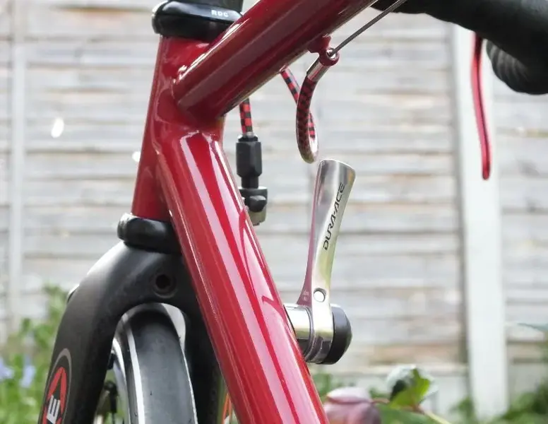

It appears to have been fillet brazed, this is a no-no for 753 which needed to be built using lower temp silver solder. So either its been cooked or its not 753. What does it weigh ?

dave yates and possibly others did fillet braze 753, naughty

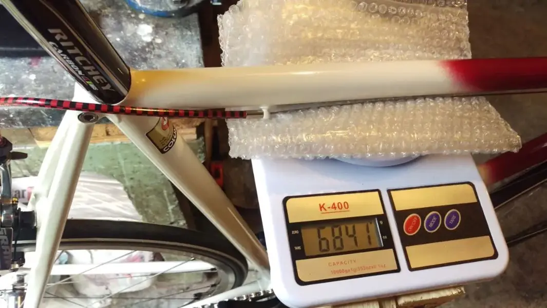

With the paint off and totally striped frame it is down at 1.656Kg, 0.603Kg for the forks. I have been looking at Columbus tubing and there is one set down at this weight with ribs in steerer only that is recommended for TT frames and therefore I assume Lo-Pro. This is the EL set. Only thing is the seat tube is down at 0.7mm on mine and the EL tube is 0.8mm

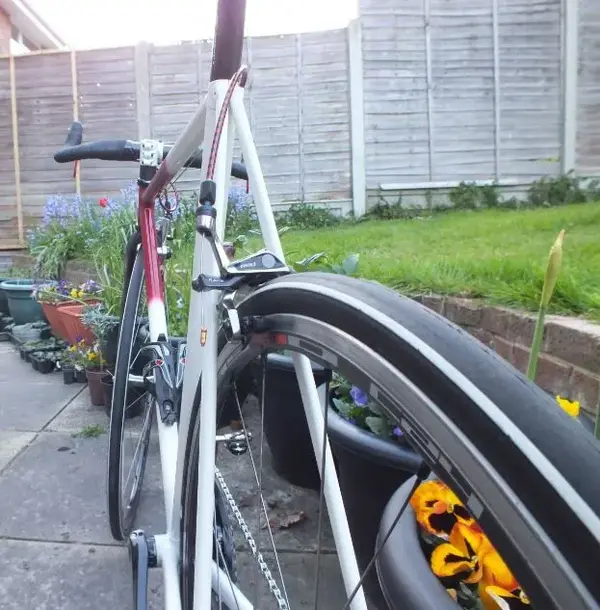

It also has triangular section seat stays which has puzzled me for a while, not seen many frames like this, but it is difficult to get pictures of them. They are 16x11mm in the middle of the stay going round at the bottom.

It's not "not recommended" to fillet braze 753, it is just unusual, but possible - different silver solders have different melting points. a normal temp silver used first to make the joint then a lower temp and thicker silver to make the fillet.

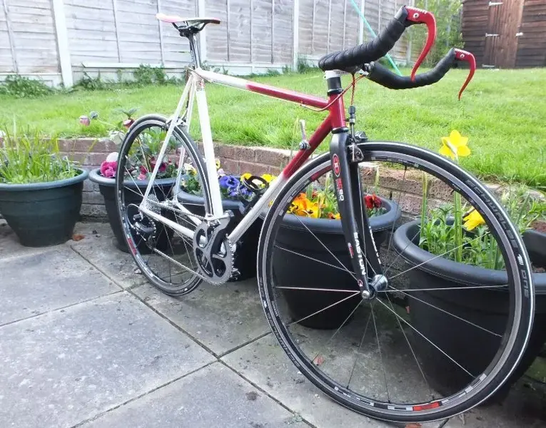

This turned out to be a Columbus frame and is now built up into a bike for sprinting around on. Been out couple of times and it goes well. Perhaps should mix Shimano with this frame, but already had the parts when I found out what it was.
