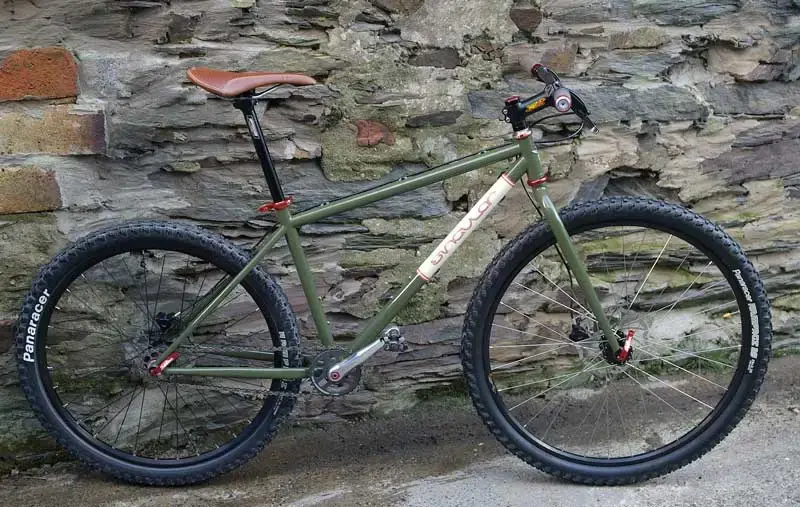

You can see from the photograph that the offset seems more noticable with the Singular forks (or maybe not...).
Mmmm..offset does semm to be slightly more raked out on the Singular fork. Having said that your chainstay appears to be running up towards the BB?
I'm going to give it a go, but i'm thinking a fork closer to 420mm may be the way forward :roll:

Thank you :)
The lack of BB drop is only an illusion - I've just measured, and with the EBB set at its highest position (which is sort of where I like it) bottom bracket drop is about 30mm, so about 35mm or so to the nominal BB centre.
Anyway. it's whatever it ends up being, as the frame and forks are specifically designed for each other - the forks aren't the same as those on the 29ers (which are longer). The Hummingbird was designed from the ground up to be a 69er, with the option to use suspension forks and a 26" wheel if you want to (but I never have wanted to 8) ).

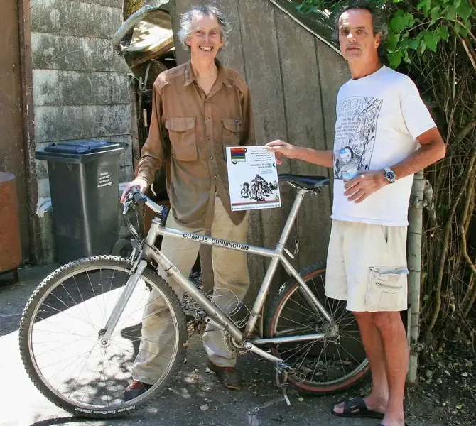

I went across town to Charlie Cunningham's house awhile ago to take some publicity photos for the OWMTB. Here is one of myself and CC with his personal bike. You'll notice it has a 29er front end on it. He said he built the longer fork and bigger hoop a few years back and put it on his original frame meant for 26" wheels to get a little more cush in the rigid front end, and he likes the result! Pat

OMG! I think i need to go and sit in a darkened room somewhere.
A 29er wheel on a 'ham. Thats like painting some headphones on the Mona Lisa. Shocked!

Yeah, Dr., but the painter in this case is the original builder! Charlie says the bike handles great and I see him riding it around town and in the woods here all the time!
Ahaha...the plot thickens.
Maybe if it doesn't work in my modern frame i'll try it on one of my older ones, with a steeper headtube, and hope that works :D
Jumping the gun a bit i know :roll: but i think a shorter fork will be in order.
More proof that if the geometry is right, they work well.
