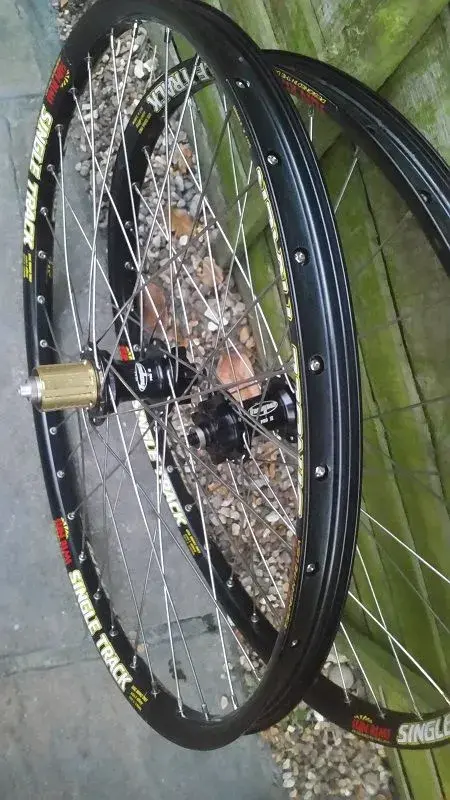

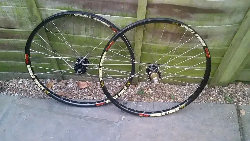

No idea what the last post is all about, but a belated post from me with the build wheels. The LBS were quite impressed with them, wish that had reflected in the price for the 'true' they did.
