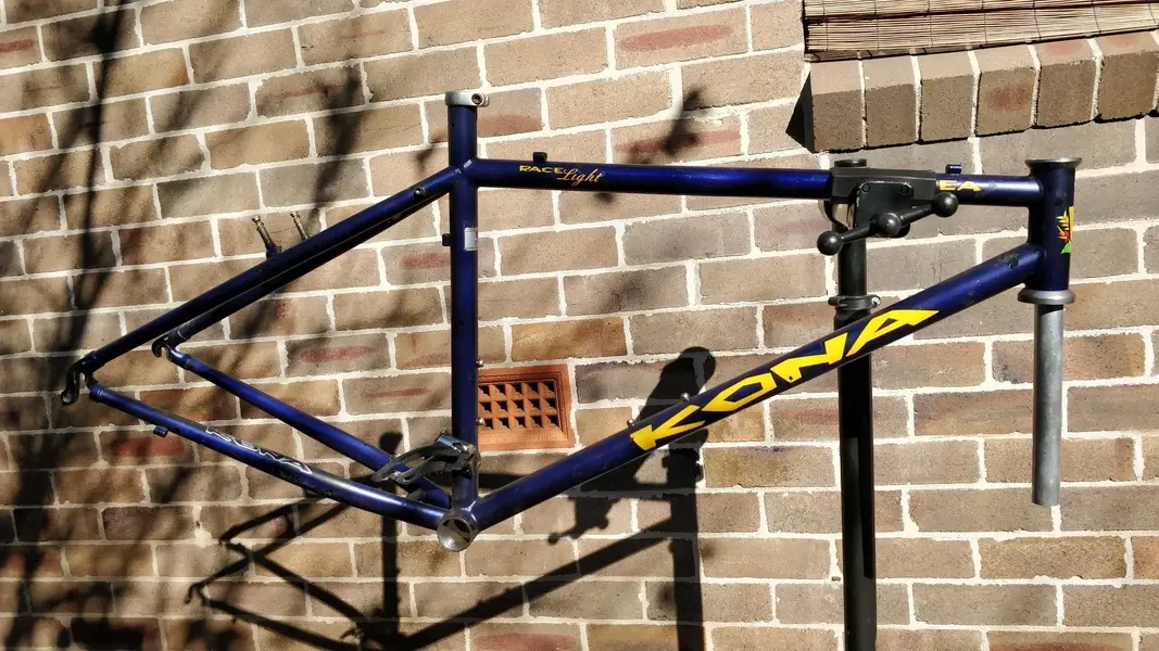

How to run full length cable outers without guides?
The only thing that beats gaffer tape for sheer functionality is a piece of wire, imho. But I'm hoping to turn this in to a bling ride for about town.
I want to run full outer along the top tube to the brakes and rear derailleur. Hard to see in the picture, but there is only cable guide for one interrupted cable on the top tube.
Don't mind the headset remover sticking out the head tube. Down Under, we do things upside down :P .
Does it have the bolt on cable guide under the bottom bracket? In fact has someone removed all the stops to turn it into a Single Speed?
Definitely a downtube mounted rear mech(should have a plastic guide on the BB, possibly missing?) and top tube mounted front mech with V brake type rear stop. Why do you want or need full outers?
Exactly this. You don't need an outer there.
You're right. I don't need outers. All parts correct and accounted for. It's just personal preference. It allows me to run a straighter route and I think less maintenance.
I will admit it won't look as neat or "proper" (although later Konas went with the top tube route), no matter what attachment method I use. Anyway, I'll post up the results in a build thread one day...

al-onestare":12pf4e7t said:
Great call. Make sure to dremmel off the cable stops to improve aerodynamics

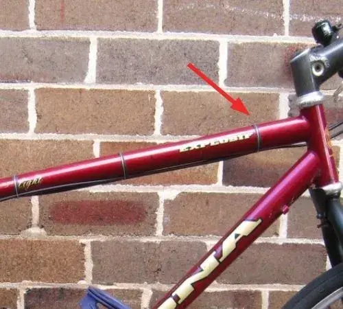

You mean like this? Been there. Done that. :shock: :lol:
Don't worry. There was a reason to the madness. It kept catching and tearing my shorts when I was out of the saddle. This frame's a keeper, so I'm not worried about resale value. :)
