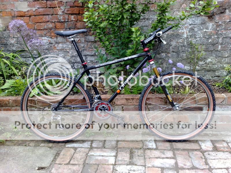

I'm currently considering which forks to chuck on my clockwork, its 1999 so would have been fitted with 80mm forks.. I think. I'm looking to up that to 100mm. Below are the results of my highly scientific experiements... :|
Pic 1: the standard.. (yawn)
Pic 2: looks about 100mm to me.. :D
Pic 3: is for the slackers amongst you.. :wink:
Whats ya thoughts?

In fact I think picture 1 shows a Manitou Spyder R, which may have had a nominal 70mm travel, but I doubt whether it ever achieved it. And its A-C length of 43cm is a lot less than even an 80mm fork.
It's a retro bike man (or not even that by some spurious age-based definitions of 'retro'), but there are plenty of choices at around 43cm - an RC36 set to 70mm, a 70mm Z2 or an SID set to 63mm will all give you the handling the designers intended. If you want modern levels of travel, why not buy a modern Clockwork?
