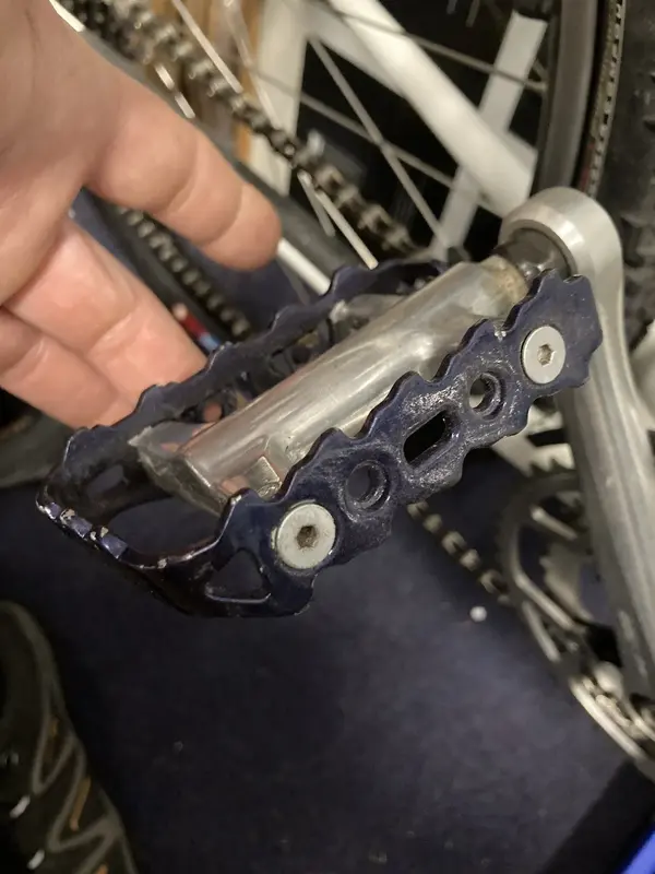

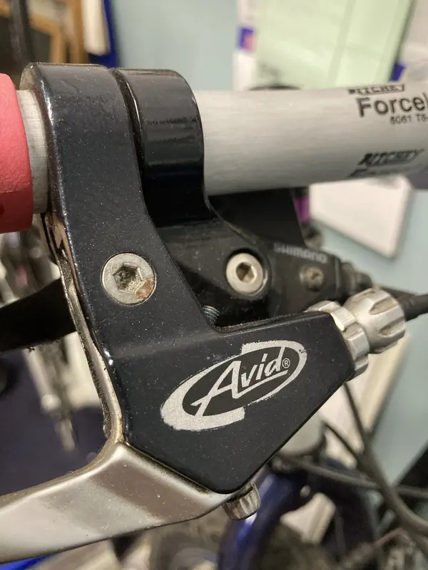

Someone will likely answer better than me! I will throw up some pics of parts I did for a fine wheather rider bike many years ago, its holding up amazingly after careful masking and painting, and leaving in the boiler house at work to 'cook' nice and hard before fitting! regards Ben
These parts were done with mostly upol cans. I have access to full spray gear and use a detail gun for car work when I paint frames… and 2k laquer which I wouldn’t suggest you do at home. For parts though take time and decent results that last are possible.
