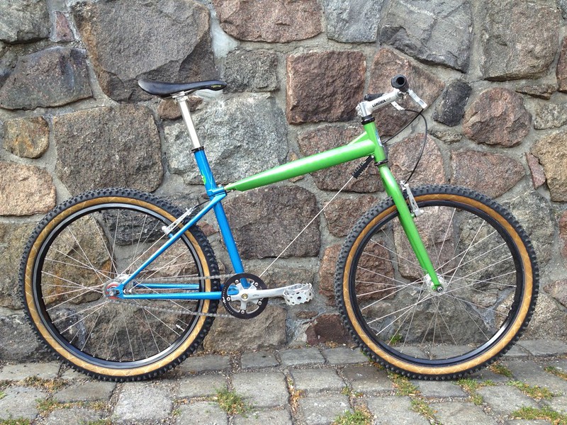

I tried a lot of Bikes as Singlespeeds.
The Ghostring sucked. ;)
img_2581-jpg.437562
So i was going the way caemis said "frames with replaceable dropouts".
img_3203-jpg.437907
img_3514-jpg.437909
And ended with a "modern" Singlespeed from 2003.
viewtopic.php?f=21&t=241268
