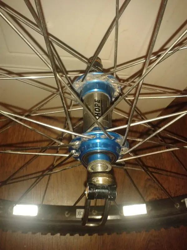

hope titanium hubs
Ha ha Radar, who is cack handed when we own 20+ year old bikes, too old and lazy maybe, I just never looked at my hubs until now and they needed it and wasn't sure on removing the cap retaining things, I actually have the original packaging with exploded view sheet etc, but it's in one of those safe places. On the upside while searching for that I found the brand new xt deraileur set circa 1990 with box etc and a tub full of titanium bolts etc :-)
The method described is for a suspension amongst overs which is probably the hub you have unless its a fatso front(and without a pic..........) Fatsos is a whole nuther kettle of fish :shock: Tricky job that yin :?

Clean it up and check for any cracks developing, these look early as they moved to extended cap dropout spacers 1994/5 so I'd guess around 1994? if you find your documents.

This it :?

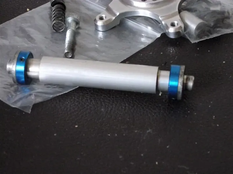

Little grubscrews on the sides of the spacers. Notorious for rounding off due to size so lube them first. Rounded can sometimes be removed with a small flatbladed screwdriver held in with maximum pressure.
Thanx Dyna-ti
Thats helpful to see it dis-assembled know what I'm aiming for now, no grub screws on mine, and no room to stick a screwdriver down the back to ease them off, starting to think wifes new carving knife shimmied in might be a real option. Destro... I mean dis-assembled pic's to follow :wink:

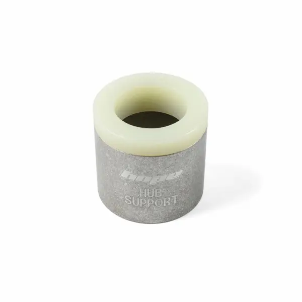

I use a deadblow hammer(Or any soft jaw hammer-not metal)
And the hope nylon support tool, which is best thing for the job, decades of reviews/tests etc.
https://www.ebay.co.uk/itm/Hope-Nylon-W ... SwwH9d6W6v
Cheap and invaluable, I wouldnt service a hub without it.

What I found worked really well on a particularly stubborn bigun recently was to place a small socket over the bit that goes in the fork leg but has a outside diameter small enough to go through the coloured collar. Then place it on the hub support that Dyna-ti referred to and it will then tap out the lower bearing as well.
