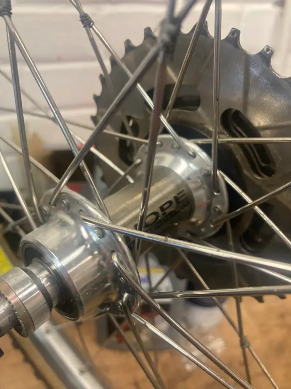

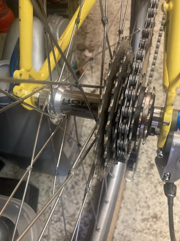

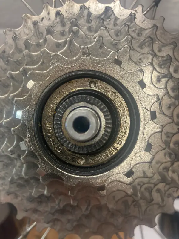

I’ve got a reasonably nice screw on freewheel on my Hope Titanium hub. It’s an IRD. I think it’s a 13-32 7 speed. It uses the same splined Shimano tool to fit/remove as the lock ring on a cassette. I bought it from SJS Cycles. It wasn’t cheap but so far seams decent quality. I’ll take a photo later when I’m out the garage and post up a link to them on SJS Cycles website.
I would have posted a photo with the freewheel removed except I’ve just discovered I’ve misplaced the correct removal tool. Also, SJS Cycles appears to have stopped stocking these. It’s an IRD Cyclone Mark 1. I have read about people having issues with them but mine’s been fine. My rear hub is exactly the same a the Hope one a few posts up. Hope this helps
