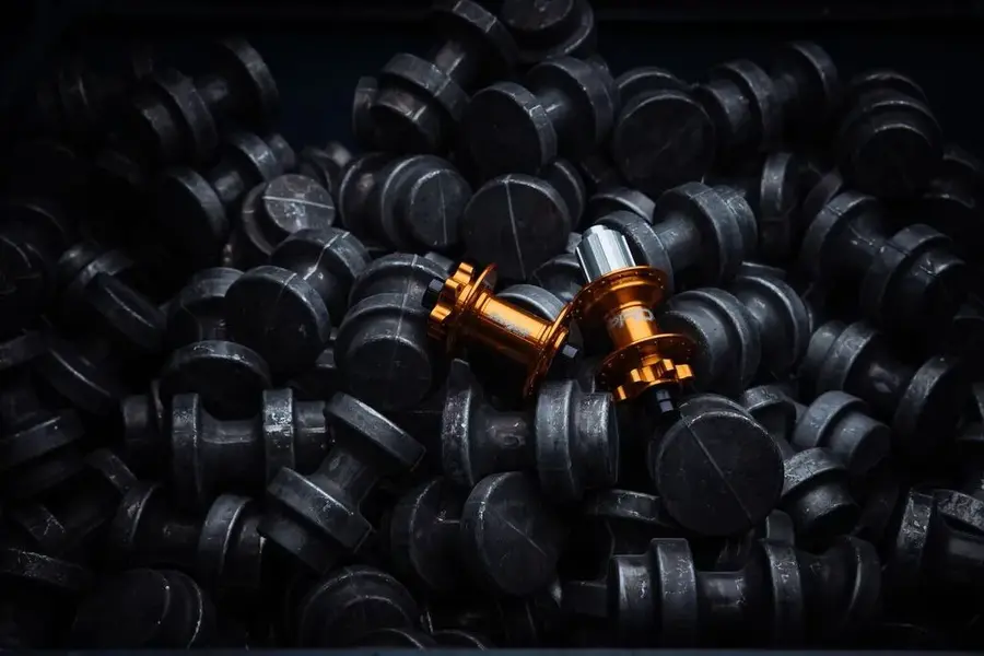

This is why Hope switched to a forged billet with CNC machining, rather than just starting with an extruded raw material.
I think this has been the norm since the Pro2 hubs.
Companies such as Shimano turn out millions of hubs with an even closer net forged billet, in which the grains are even more closely aligned with the final form surface, so are far less susceptible to stress or corrosion cracking.

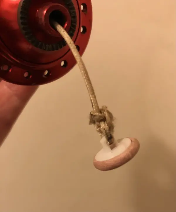

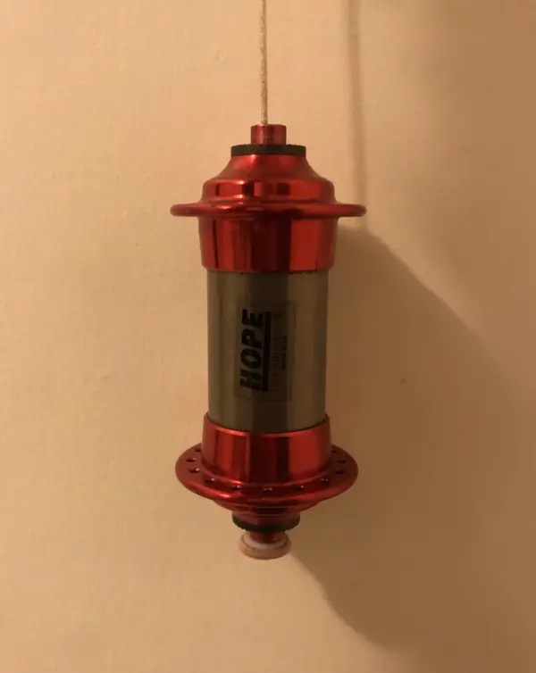

I have a small display of cracked/broken Hope hubs, and a further couple of cracked hubs now being used as light pulls in the house.
Interesting idea, have you got a photo of the light pulls?
