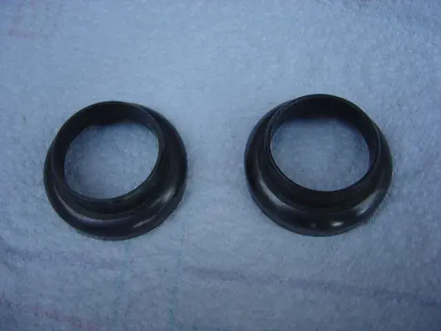

Stripped the headset and oxidised the cups using 'cold blue. Gives a nice uniform finish when items can be dipped.

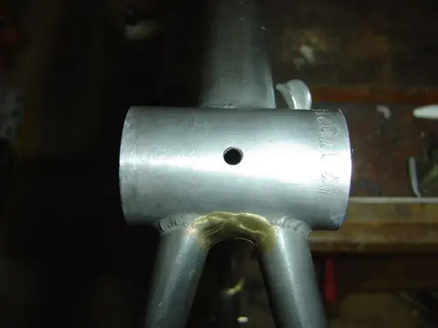

Have decided to drill a drain hole in the BB shell.

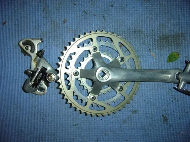

Chainset is Exage cranks with Pace rings (46 36 24) which is somewhat higher geared than I am used to. Would also need to buy a BB for it. Rear mech M735 (XT) is in a very poor cosmetic state (worse than appears on teh photo).
So for the time being I am going to use a spare octalink M750 chainset, M750 rear mech and XT bottom bracket. This is for narrow 9 speed chains so will have to see how well it mixes with the 7 speed cassette. Will try the M735 front mech which is in good condition.
Have coated everything in a silicon spray to keep tarnishing at bay. My intention is to get the bike built up to give it a try before spending any money on it.
