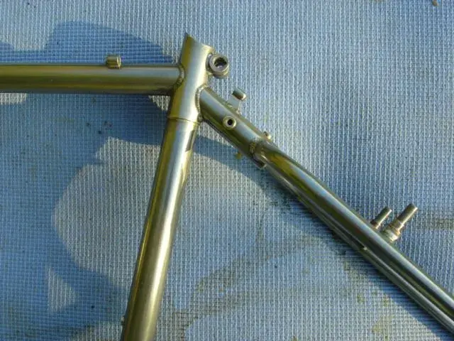

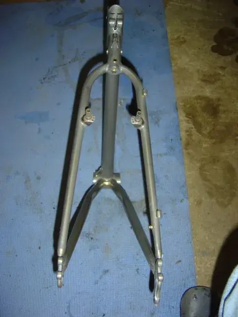

Well I've stripped the paint off. Some years ago an EU directive banned the active ingredient in paintstripper. Those who have tried using modern paintstripper will be aware of how useless it can be now. A frame that I stripped earlier in the year took many weeks and a lot of scraping. However, this clockwork turned out to be much easier than I was expecting - probably because of the lack of lacquer, and the scratched condition of the paint.
Observations:
1) The grey/blue finish of the metal under the paint suggests it was treated (galvanised, hot or cold blue treated?). Wire wool does not cut this back very easily. The treatment has worked as the only evidence of any rust is a small area within the bottom bracket housing as you would expect.
2) The rear drop out, bosses, cable stops, butted seat clamp tube are all brazed on. There is also a large blob of brazing material between the two chainstays where they meet the bottom bracket - can't immediately see its purpose.
3) Drilled holes, bosses, cable stops, tube ends all had burrs - presumably too labour intensive to debur - tends to get covered up by the paint. Will debur these.
4) A number of weld splatter blobs - again only noticeable once the paint was removed. Will file these down.
5) No butting on the headtube.

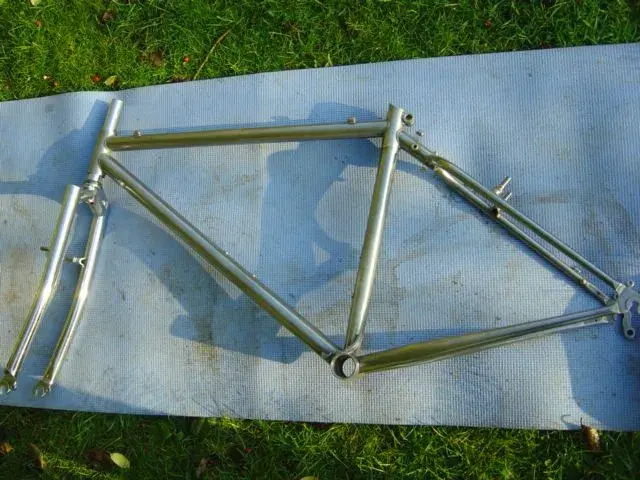

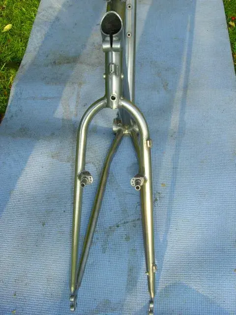

My initial attempts at removing the dull grey finish didn't look too promising. With renewed vigour, after a few days off, I took some sandpaper, wire wool and autsol to the frame and it did polish very nicely. That shine represents about a days work on and off.
Looks fantastic at the moment - hand polishing leaves a lovely patina that sandblasting etc would probably have removed. Nice contrast between gold of the brazing and the steel. But it is bare steel and won't last in its current state. So where now?
1) I have some 'cold blue' that I am going to oxidise some of the smaller parts. Tempted to try it on the frame, but most reviews indicate it is very difficult to get right and doesn't last.
2) Leave bare and regularly spray in silicon. Would require long term maintenance. However, I do use it on a bare aluminium frame and that has not tarnished yet after a year.
3) Clear coat. All reviews appear to suggest this is a waste of time in the long term. However, googling has shown up some promise for a clear coat polymer called Nyalic. Expensive at £40 for two small aerosols though - and no testament as to its long term success.
4) Have it powder coated.
5) Let my 'arty' son loose on it with spray cans (he's keen).
I'm going to let it be while I clean up the other bits and see how quickly it tarnishes in my damp and cold garage.

Find somewhere that will do clear powder coat- will stick better than paint to the polished surface!
Looks great btw but it will rust quickly
two years since I had mine clear coated over bare metal...
...and it hasn't begun to rust yet 8)
Very impressive if that is over steel. Do you recall any details - ie method and clearcoat used?
Rob
