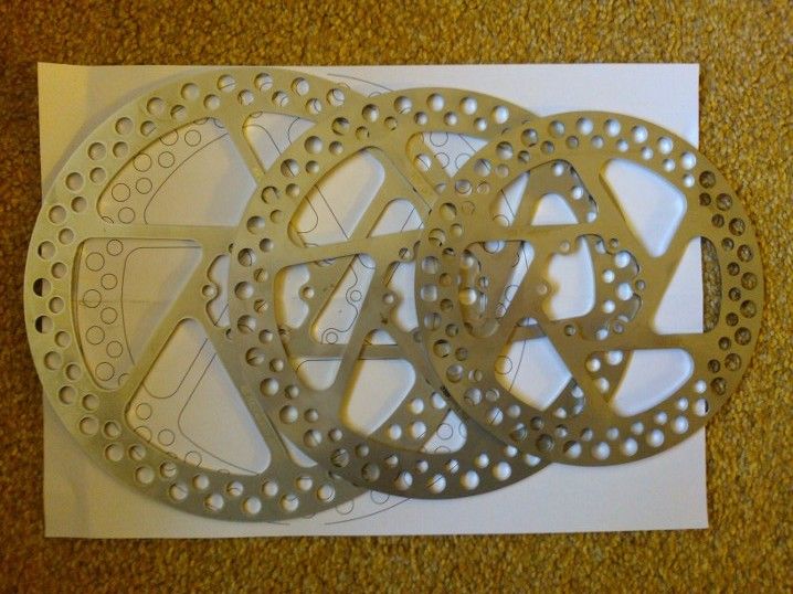

This is a 160mm C2 style disc I bought from that auction site:
It fits perfectly:
So I made some 165mm ones today to replace it as I couldn't find any Hope C2 165mm discs for sale.

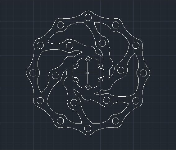

Then I got carried away and started making funky designs.
Here's my beta chain one:
Going to change the inner bit into something that looks like a sprocket. :twisted:
P.s. The designs look a bit dodgy on screenshots for some reason, I can assure you then are perfect circles and round when they are printed.

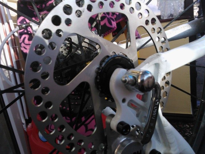

Fixed (using a traditional method of drilling) and fitted.
They're spot on!! :lol:

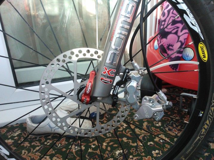

Test fitting my M4's with a 203mm disc:
Rear 160mm disc.

I'm going to design some discs specifically for the M4's. It was just to make sure that a 203mm disc fitted.
Also, rather strangely, I can increase the radius of the front disc as it's not using the full pad.
My original design was 20mm deep, however I'm going to increase the depth of the brake surface by 4mm. Also increase the length of the arms by 4m.
It will make the disc about 201mm in diameter, the 203mm was a tiny bit too big.
