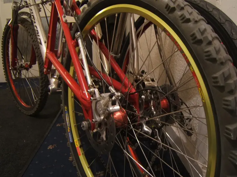

I'm sure someone asked me what hub I have, it's a Hope one:
Makes a rather loud noise when not pedalling. :roll:
Makes a great noise and a British noise too :wink: none of yer buzzing bees that sound absolutely nothing like a bee a wasp or even a hornet.
The hub in your pic is a ti-glide.So named from the 6/4 titanium middle section on these models.

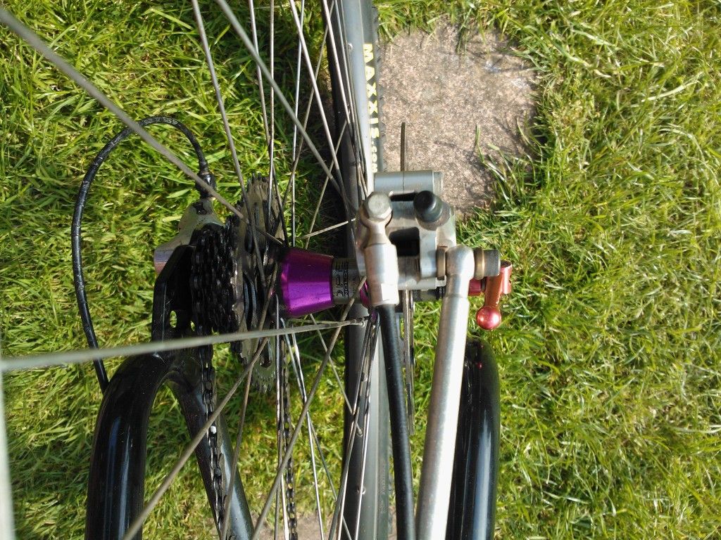

Heres one of my current bolt on adaptors.[on a santa cruz tazmon]
Its different in that although it uses the exact same short axle,dummy dropout,xl skewer and endnut it leaves you with an IS mount.A better set up as it allows any calliper to be used old of modern.

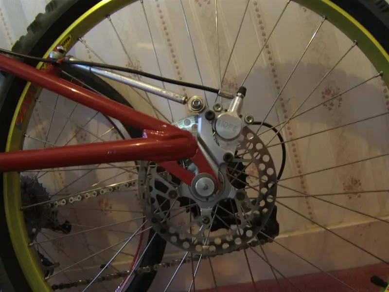

What you have there is a fairly rare torsion beam setup.
I would imagine if you advertised the torsion beam, caliper 5 bolt disc and rear wheel complete on here many would bite your arm off.
These parts are all pretty rare now (especially the axle end caps etc) and the best way to put a period correct disc on a retro frame. The set gets split up and each bit is pretty useless without the rest.
You can then buy a new rear wheel with 6-bolt fixing, Shimano hubs are much quieter (if you prefer that) and fit the cheaper to buy 6 bolt discs.
