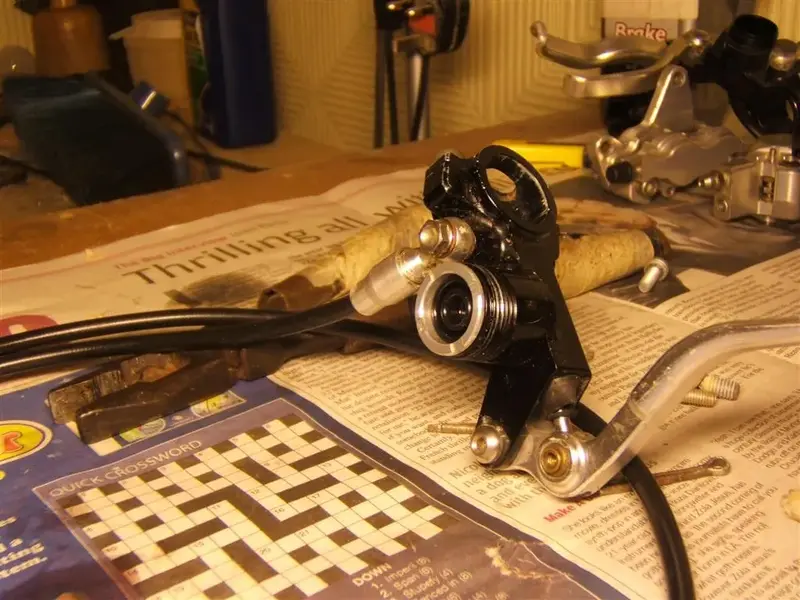

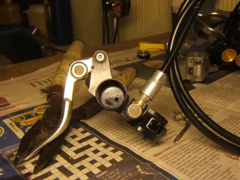

The difference in inside the reservoir.In the Open system[O2] there is an alloy bar about 2mm thick,whereas the closed system[C2] there is no bar.I have no idea why its different or why the open has it and not the closed,but there it is :D
The insides of the caliper is slightly different in that the closed has a post that the spring return screws into,the open doesnt have any return springs in behind the piston,it's hollow much like modern versions
Some pics :)

I'm guessing the bar is there as the Open lever is to hold the diaphram in place - as the adjuster, etc. would do that in the Closed lever.
I'm quite interested to see what turns up now - whether it's a modified closed lever, or an open lever with the top missing. But as the seller says that the pistons on the caliper move, it must be a working set-up of some kind? :?
Hopefully all will be revealed soon!
Oh and out of interest would you be able to use 160/180 rotors with these (as this will only work out at 2.5mm difference each side) as I already have some?
In my first pic .It shows whats under the open cap,the diaphragm is held in place with the alloy ring.The cap would then screw on over the top of them both.
